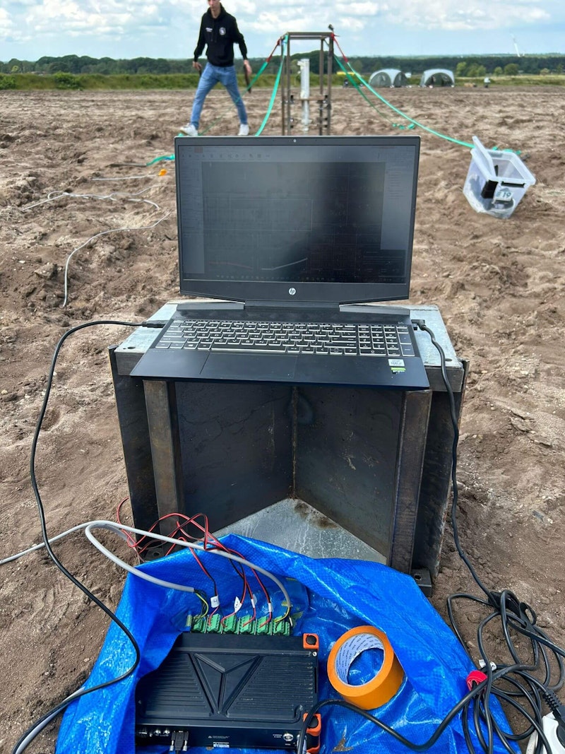

After designing and manufacturing the Microman, the final validation before a launch is a static fire test. A static fire test is a test in which the motor is on a test stand that is securely attached to the ground. We then ignite the motor and record the test data. To record the data, AQUILO Rocket Team uses a Dewesoft data acquisition system along with the Sirius box.
Test setup
When testing a solid rocket motor, three data types are essential to acquire: temperature, pressure, and thrust. For this test, we did not use a pressure transducer due to budget constraints. As such, the setup consisted of four thermocouples and two load cells.

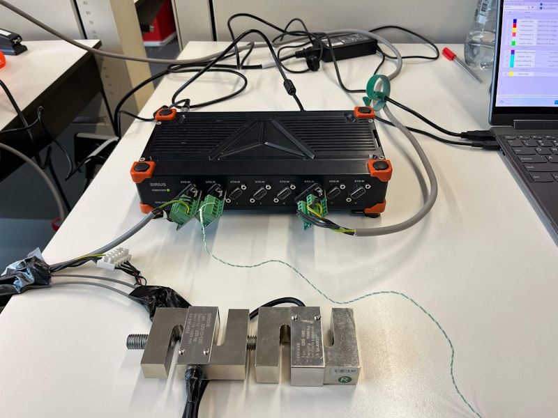

Load cells
The load cells are of type S and have a range of 200 kg to 1000 kg, meaning they can measure loads between 1962 N and 9810 N of ultimate load (tension or compression). The two load cells are mounted in series and should provide approximately the same reading during a test, which we can use to see and verify the differences between the load cells.
This difference is usually negligible. From the reading provided by the load cells, the thrust of the motor can be concluded and compared with the expected performance. Using OpenMotor simulation software, the predicted thrust curve is even, which means that the thrust profile remains relatively constant throughout the burn (see Figure 10).
The load cells connect via an M12 threaded hole. This hole is located on one side and is associated with an M12 bolt that passes through the thrust plate in the test stand. The other side connects to an M12 to M6 insert. This insert is then attached to the motor via the M6 threaded rod of the forward closure, as shown in Figure 5.
For further details regarding the sensors employed, please check References 3 and 4.

Data acquisition
  • Dewesoft SIRIUS
    High-end signal conditioning amplifier with high dynamic range (160 dB), galvanic isolation, etc.
  • Dewesoft SBOX
    Powerful Data Processing Computer and SSD Data Logger
  • DewesoftX software
    Data acquisition and digital signal processing software
Figure 7 shows the thermocouples and load cells connected to the SIRIUS data acquisition system using different channels. A corresponding test setup is configured within the DewesoftX software to facilitate and organize data collection, as shown in Figure 6.
The Dewesoft SBOX and SIRIUS connect to the sensors.
Figure 6. The Dewesoft SBOX and Sirius connect to the sensors.
Figure 7: DewesoftX screenshot: Channels populated by the sensors.

Once the ignitors are in place and the countdown to ignition is complete, we ignite the PB-51C motor, and data acquisition begins.
Figure 8. PB-51C ignition
