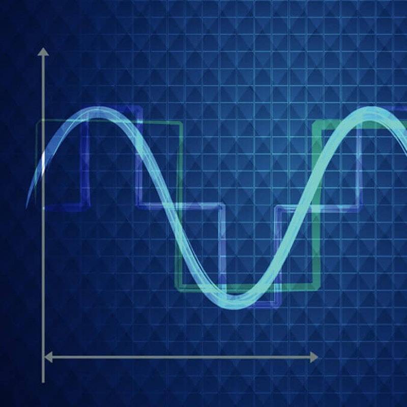

Measure harmonics and symmetrical components
The Power quality module allows measuring harmonics of the voltage and the current up to some hundred kHz. The data can be represented in the percentage of the fundamental frequency as required for the no-load current according to IEC 60076 standard.

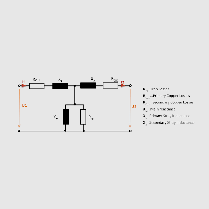

The power quality module also automatically calculates the zero-sequence impedance which is required in the power transformer testing.
The math library allows us to automatically calculate parameters like the magnetizing current, the iron losses, the main inductance for example out of the no-load test or the stray inductances out of the short-circuit tests.

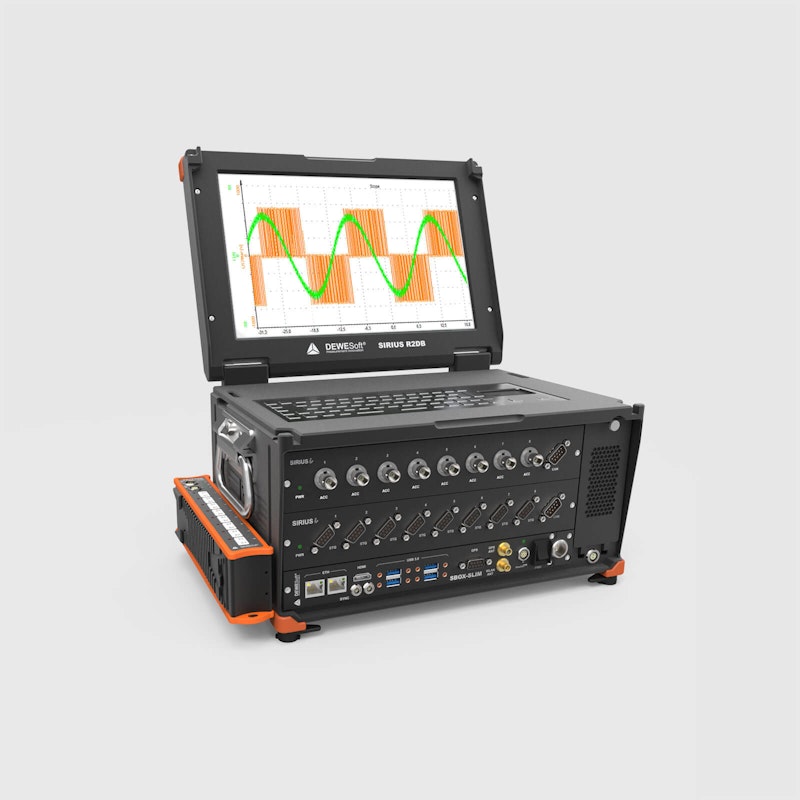

For the most typical configuration, we suggest the R2DB DAQ system with optional additional KRYPTON DAQ for temperature inputs:
8x high-voltage analog inputs
8x current analog input
3x universal thermocouple analog inputs
