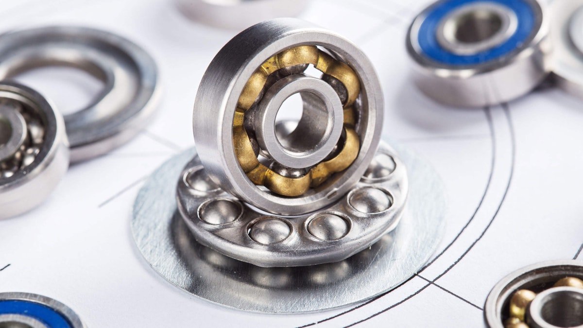

Bearings are fundamental mechanical components in rotating machinery, designed to reduce friction between moving parts and support both radial and axial loads. There are various types of bearings, including rolling and sliding bearings, each with specific applications and characteristics.
Bearing diagnostics are crucial for ensuring the reliability and efficiency of machines. Advanced techniques, such as vibration analysis and ultrasound, enable the early detection of defects and wear, helping to prevent unexpected failures and costly downtime.
Furthermore, the implementation of predictive maintenance systems, based on continuous monitoring and data analysis, optimizes maintenance interventions, reducing costs and improving overall productivity.
In summary, understanding the operation of bearings and adopting effective diagnostic strategies are essential elements for proactive maintenance and optimizing the performance of industrial machinery.
