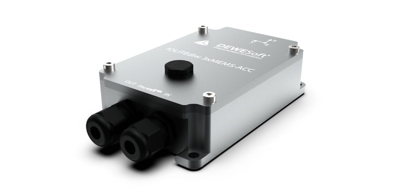

During the monitoring campaign, we used the Dewesoft IOLITEiw-3xMEMS-ACC 3-axial, low-noise (25 μg√Hz spectral noise density) accelerometer with an integrated DAQ and EtherCAT interface. The device is fully waterproof and protected by IP67. It can measure structural accelerations in X, Y, and Z, as well as static inclinations and displacements - see Figure 7 right.
