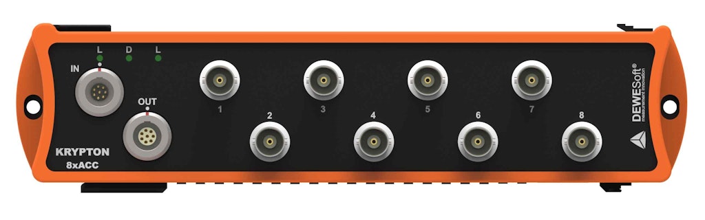

Now, we can see the modal shapes in the software. We meticulously captured the blade's vibratory response by configuring our setup with an impact hammer, uniaxial accelerometers, and the Dewesoft KRYPTON data acquisition system. The process involved careful calibration and triggering to ensure data accuracy and integrity. We optimized critical parameters such as resolution and sampling rate to capture the relevant frequency range and ensure that our analysis was comprehensive and reliable.
