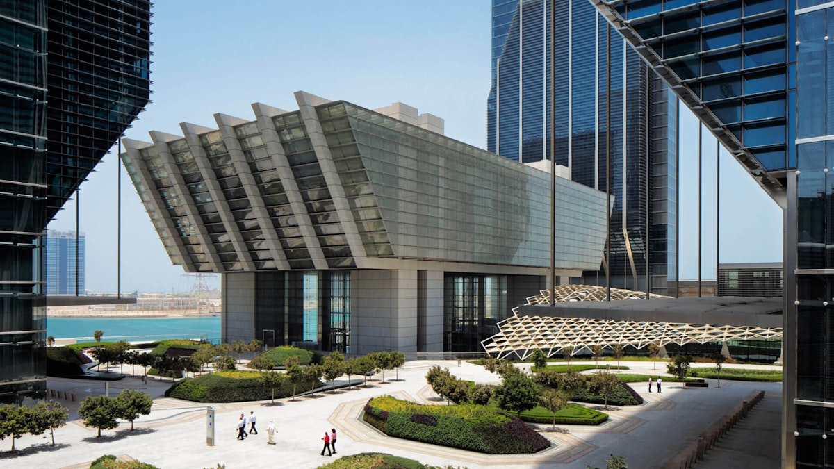

Abu Dhabi global market structrual monitoring
Abu Dhabi Global Market (ADGM) is a financial center and a free zone located on Al Maryah Island in the heart of the UAE's capital city, Abu Dhabi. Finalized in 2018 the structure under investigation extending across the entire 114 hectares of the island, now houses an international arbitration hearing center and is part of a large complex of buildings established by the Abu Dhabi Chamber of Commerce in 2013.

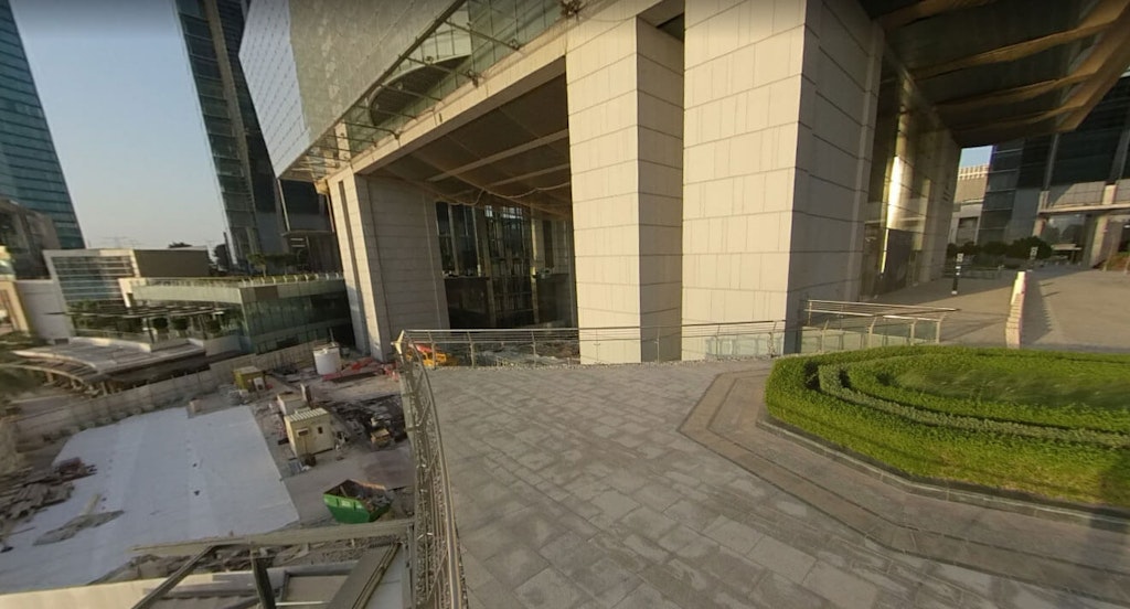

Figure 1: Construction site works at the ground level.

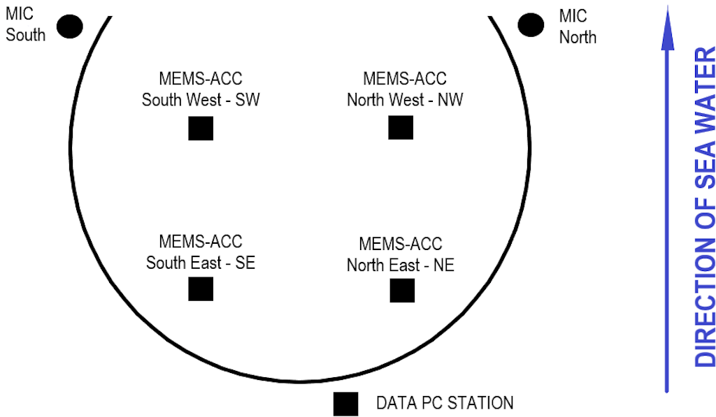

To verify whether the ongoing works are affecting the surrounding of the building, the vibration and sound sensors were installed at different locations. The vibration was measured at four reinforced concrete columns while the sound levels were checked for two locations in the surrounding area.
Figure 2. The locations of the sensors installed with their respective IDs.

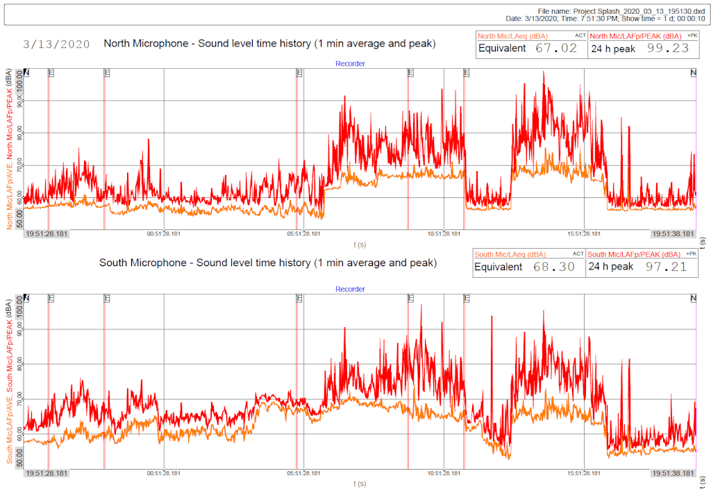

The consultants were monitoring the noise using the DAQ system and the microphones as a sound level meter - fulfilling the IEC 61672 requirements for Class I. The parameters measured were:
  • LAF peak -  the peak the Sound Level with ‘A’ Frequency weighting and Fast Time weighting, and
  • LAF average over 1 min.
In LAF the “L” represents “Level”, the sound pressure level. The “A” represents the frequency weighting which indicates that some frequencies within the audio spectrum are given a weighting. The A-weighting is the standard weighting of the audible frequencies - the range from 20Hz to 20kHz - and reflects the sensitivity of the human ear to noise.
The IEC 61672-1 standard on sound level meters describes two-time types of weightings, Fast (F) and Slow (S). They both dampen the reaction of the displayed level to a sudden change in the sound level. Fast Time Weighting is generally the time weighting used for environmental noise measurements, where sound varies over time.
The Peak is the maximum pressure level value reached by the sound and is well-suited to measure impulsive sounds.

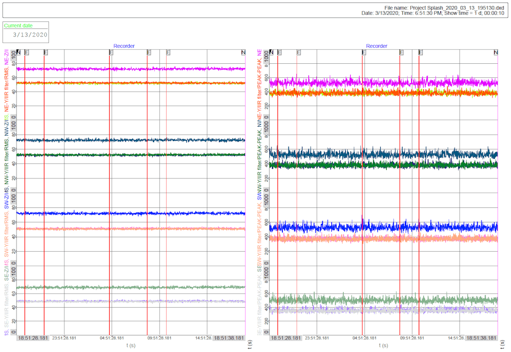

The vibration parameters used were:
  • Root Mean Square value (RMS), and
  • Peak-to-Peak (P-P).
The RMS value is the instantaneous values within a certain duration of time and relates to the power of the vibration. The RMS is generally a useful indicator to represent the vibration level in practice as it is directly related to the energy content of the vibration profile and thus the destructive capability of the vibration.
The peak-to-peak value has the benefit of providing the maximum excursion of the wave, which is useful when looking at displacement information.
Fig. 3. Sample of the noise monitoring report.
The construction/demolition works started at around 7 am and were concluded at around 6 pm. The noise monitoring reports show that the highest LAF peak noise registered during the monitored period was 99dBA.
Fig 4. Sample of the vibration monitoring report.

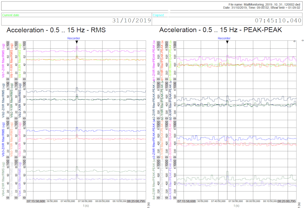

Overall, the vibration monitoring system did not detect any significant acceleration levels due to the construction works. However, a small earthquake was noted on the 31st of October 2020.
Fig. 5. The system registered a minor earthquake in October 2020.
