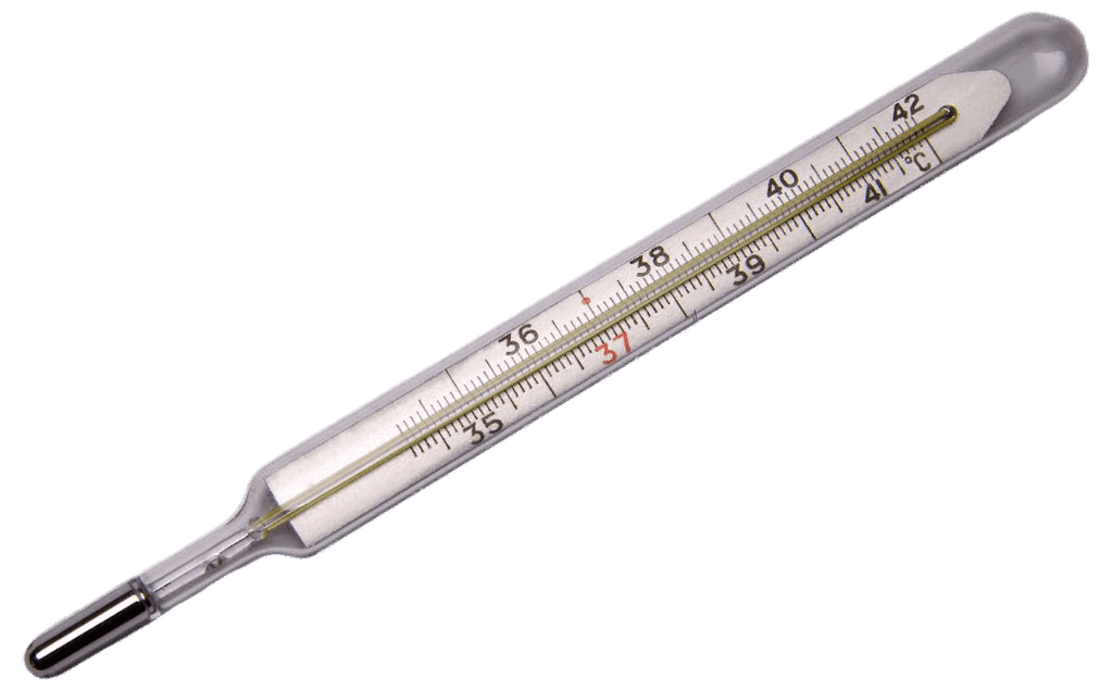

Sensors are used in our everyday lives. For example, the common mercury thermometer is a very old type of sensor used for measuring temperature. Using coloured mercury in a closed tube, it relies on the fact that this chemical has a consistent and linear reaction to changes in temperature.
By marking the tube with temperature values, we can look at the thermometer and see what the temperature is. The precision is somewhat limited due to the visual size of the scale markings, but it is sufficient for its intended purpose.
Thermometer
Of course, there is no output (other than the visual one). This kind of thermometer, while useful in the oven, or outside the kitchen window, is not particularly useful for data acquisition applications because, in order to record the values from it, we must have an output that can be digitized. So, temperature sensors have been invented to measure temperature and other physical phenomena and to provide an output that we can display, store, and analyze.

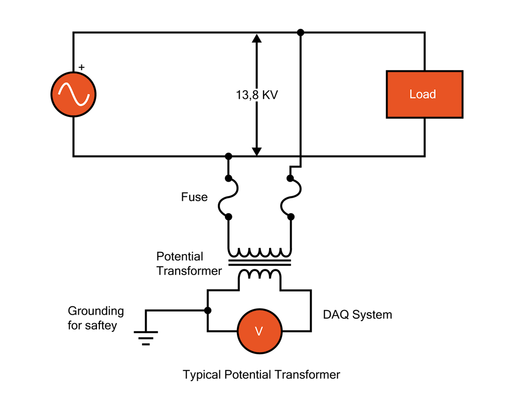

Typical Potential Transformer
The typical PT uses a transformer to step down a very high potential - even higher than 10kV - down to a safe level. It can be placed in series with or across the circuit being monitored. The transformer’s primary winding has a large number of turns compared to the secondary.
Because the DAQ system connected typically has a very high impedance, very little current will flow, therefore the PT’s secondary winding experiences almost no load at all. Most PTs output between 50 and 200V, which nearly every DAQ system can accept.
PTs are available for outdoor usage and those designed for indoor usage. There are also those designed for electrical metering applications. There is also an alternative to the pure transformer type which uses a bank of capacitors after an intermediate transformer to further step down the voltage. These can be less costly because the relatively low step-down ratio intermediate transformer is less expensive than the conventional wound transformer with a high step-down ratio.
A third variant is the optical VT. Optical VTs are usually found in power substations, and not often in DAQ applications. Since they operate on the principle of the Faraday effect, whereby the polarization of light is affected directly by a magnetic field, they are inherently isolated. They are also extremely accurate.

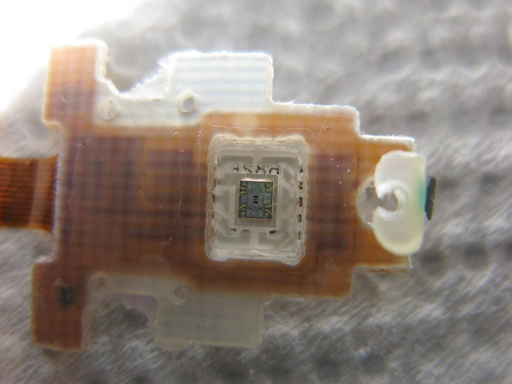

Photodetectors aka proximity sensors, as well as their semiconductor-based cousin, the photodiode, are used to measure the distance to or between objects, and also to sense either the presence or absence of an object.
These are used in a wide variety of industrial applications, including factory process lines, making sure that objects are spaced properly on a belt, or detecting when a new object is in position on an assembly belt. They are also used in automotive applications, detecting the presence of another car or object, as well as alarm systems, and CD and DVD drives.
Typical photodetector from a CD drive

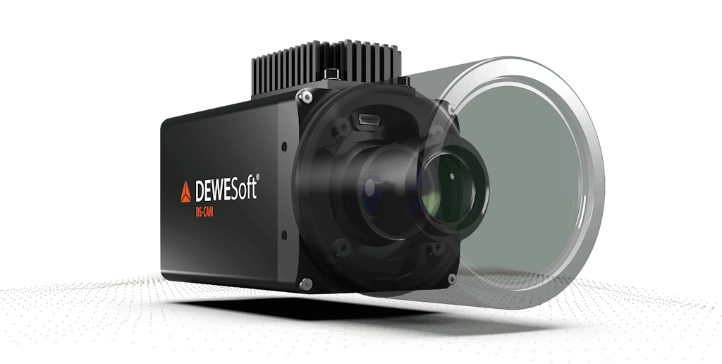

Dewesoft DS CAM cameras
Cameras are also an important part of DAQ system measurement applications. In fact, all of the DAQ systems made by Dewesoft can utilize one or more video cameras and record video in sync with the analog and digital data that they’re recording.
Datafile recorded with the Dewesoft DAQ system showing analog and digital data synchronized with the video
Professional vs. consumer cameras
On one end of the capabilities spectrum, it is possible to use a very inexpensive web camera to add a video to your recordings in some data acquisition (DAQ) systems. But on the other end are industrial-grade cameras with better lenses and the ability to synchronize the framerate of the camera to the process being recorded and/or with the data acquisition sample rate.
For example, the DS-CAM-600 shown here can output up to 336 frames per second at full HD resolution, and up to 600 frames per second if the size of the image is reduced. The camera is also sealed to IP 67 so that it can be used in wet, dusty, and harsh environments. Within Dewesoft DAQ systems, multiple cameras can be used at the same time, providing different viewing angles of the object(s) under test.
When Dewesoft added the common webcam to its DAQ systems in the early 2000s, it completely revolutionized the DAQ market. The next logical step was using industrial cameras whose frame rates could be precisely controlled, and which offered better resolution and speed.
Mechanical mounting and rugged construction are also critical with any sensor, and this has been designed into today’s best industrial machine vision cameras.

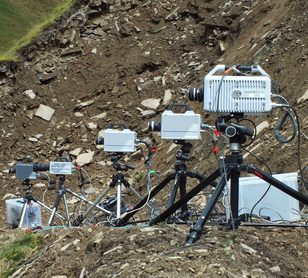

High-speed cameras
High-speed cameras are useful for capturing extremely fast-changing events. You’ve probably seen slow-motion replays of a balloon popping, or a bullet impacting glass of water - those videos were captured with high-speed video cameras.
An assortment of high-speed video cameras from Photron
High-speed cameras from Photron capture up to 500,000 pictures per second. This data is captured to RAM and then is immediately available for replay. It is possible to synchronize Dewesoft DAQ systems with Photron cameras so that they are both triggered at the same time, and when the test is over, the high-speed video is immediately transferred to the Dewesoft DAQ system and automatically synchronized with the other data. You can replay it in perfect sync with all the data from other sensors.
Video from a fuse switch test using Dewesoft DAQ equipment and software

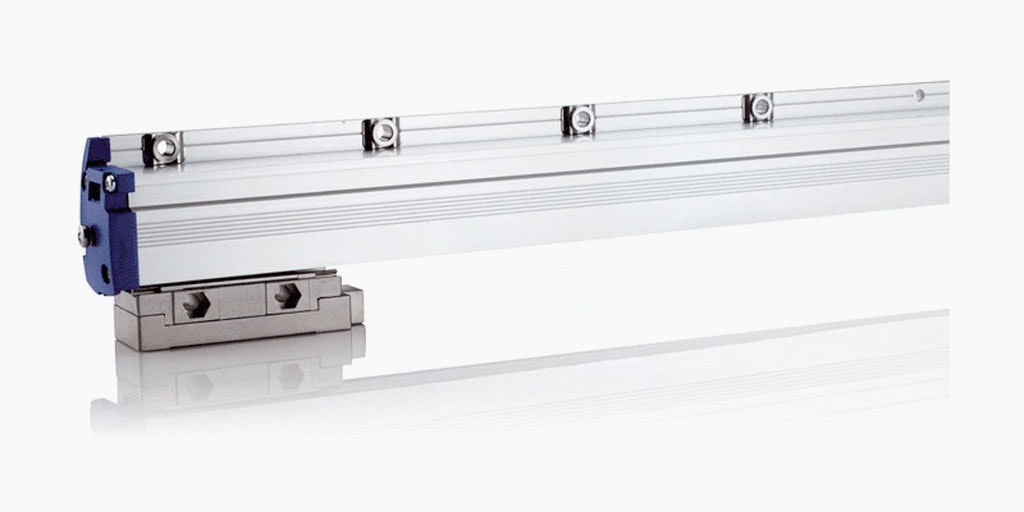

Linear encoders
linear encoder measures position along a linear path. Unlike a rotary encoder which has a circular plate inside that allows it to measure shaft position, most linear encoders move along an external scale and determine their position from markings on the scale.
Linear Encoder
A perfect example is an inkjet printer, which uses a linear encoder to precisely move the printhead back and forth along a scale during printing. High resolution and accuracy are obviously required in this and countless other applications.
The most prevalent sensing technology used with linear encoders is optical, however, there are encoders that also employ magnetic, capacitive and inductive technology. Optical encoders provide the most accuracy and the highest possible resolution, however, care must be taken to prevent contaminants from interfering with their operation.
There are both analog and digital output linear encoders. Dewesoft systems are better suited to digital outputs since they provide A and B outputs very similar to incremental rotary encoders as described in the previous section.
