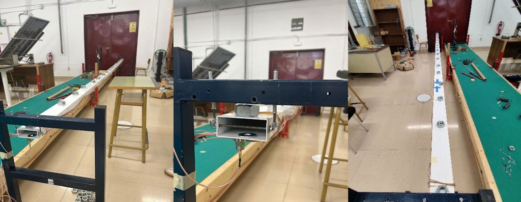

Firstly, we provide a detailed description of the beam, experimental setup, instrumentation, and measurement procedures, along with supporting figures. It’s essential to know the details of the structure.
The aluminum (E = 70 GPa) beam is in a simply supported configuration. It has a length of L=6 m with a hollow rectangular section of 80 mm (width) and 40 mm (edge). The thickness is 2 mm, and the beam has a total mass of 5.15 kg, excluding extra nuts.
The extra nuts are then additional masses, each 0.190 kg, totaling 19 in number, spaced along its entire length, approximately 33.3 cm apart. Figure 1 gives an idea of the structure.
Figure 1. The simply supported aluminum beam under study.

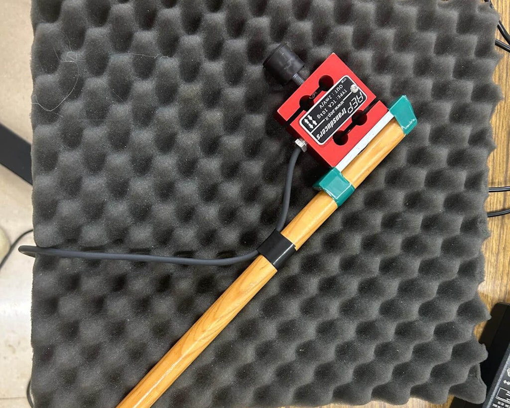

The experimental setup for excitation is an “Impact Hammer”, and we used an AEP transducers® TCA 10 kg load cell (2mV/V output) in a full Wheatstone bridge configuration with offset correction (see Figure 3). We consistently applied impacts at the beam´s point 2 (blue point), one meter from one support.
Applying the impact hammer.

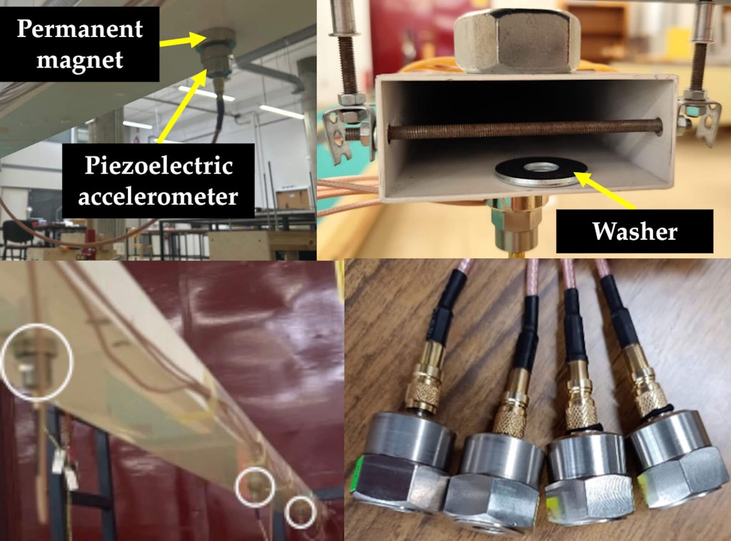

The response is measured at the red points using piezoelectric accelerometers arranged vertically. A total of seven MMF® KS76C.100 IEPE (sensitivity 100 mV/g) units (see Figure 4.d), one per point, are used (see Figure 4.c).
We attached the accelerometers to the beam by permanent magnets (see Figure 4.a), held in place by steel washers (see Figure 4.b) inside the aluminum hollow section. Magnetic sensor mounting is a widely used non-destructive technique, particularly when ferromagnetic materials are present, as seen with the inserted washers [3].

Figure 3.  AEP transducers, TCA 10 kg load cell, used as an Impact Hammer for controlling and monitoring the excitation.
Figure 4. Piezoelectric accelerometers MMF® KS76C.100 IEPE.

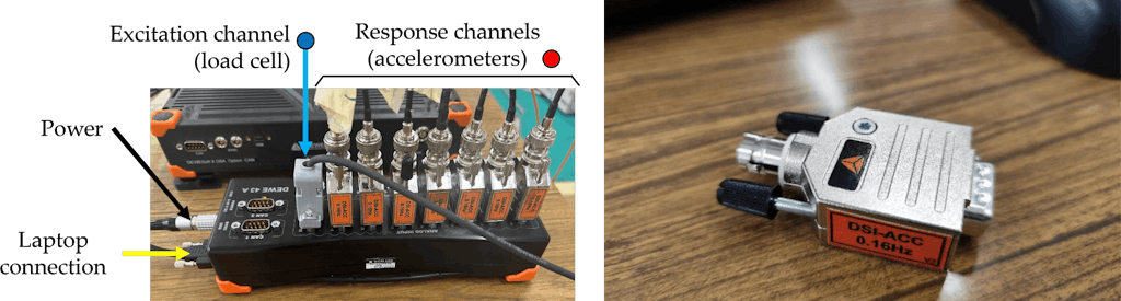

We used a Data Acquisition System (DAQ – datalogger), specifically a Dewesoft DEWE-43A EDU unit. It comprises eight analog input channels, and we connected the accelerometers and the load cell as shown in Figure 5. To implement the described methodology, we utilized DewesoftX software on the computer connected to the datalogger, along with the Modal Test license, which is part of the DEWE-43A EDU pack.
Additionally, we utilized Dewesoft DSI Adapters for universal amplifiers (TEDs, IEEE 1451.4) to connect the accelerometers to the system via the DSUB9 input ports, as illustrated in Figure 2. In the software, the analog-in palette configuration, depicted in Figure 6, sets the sampling rate (dynamic acquisition rate) at 400 Hz for recording time signals.
Figure 5. Dewesoft DEWE-43A EDU experimental setup.
Figure 6. Analog-in palette with channel configurations: excitation (load cell – channel 8) and response (accelerometers – channels 1 to 7).

  • Seven Dewesoft DSI Adapters - IEPE signal adapters that turn analog input amplifiers into direct IEPE, charge, thermocouple, shunt, voltage, LVDT, or RTD input.

  • Our impacts at the beam’s point 2 never exceed 1g (approx. 10 N, 9.81 m/s2) to prevent excessive noise and vibration, as well as relative movement (bouncing) between the nuts and the beam.

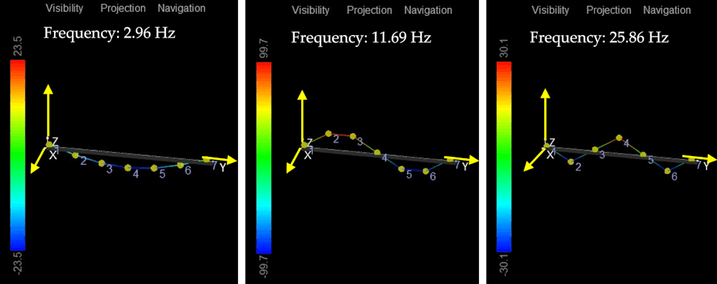

Figure 7 depicts the beam’s first three vibration modes identified after performing the EMA.
However, video animations of these mode shapes provide a more accurate virtual representation of vibration at Natural Frequencies. The animations visualize the different ways the beam can vibrate at the frequencies mentioned above.
The number of half-sine waves that fit within the beam’s length characterizes these modes. The first mode occurs at 2.96 Hz, and it’s the simplest one, characterized by a single half-sine wave. The second mode, at 11.69 Hz, introduces a central node (point 4 in Figure 2), where no vertical displacement occurs. Finally, the third mode, observed at 25.86 Hz, features two such nodes (points 3 and 5), creating three distinct segments that vibrate in alternating directions.
Since displacements are small, a more generic video of the vibrating structure during the EMA procedure (response after impacts and time windows averaging) would not have provided the desired displacement view, so the representation available in DewesoftX is of great interest.

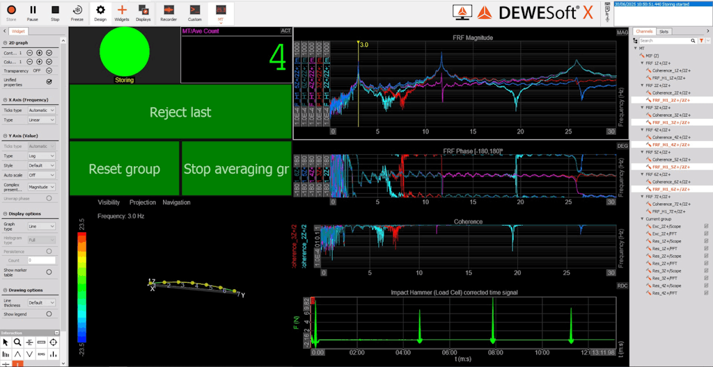

We obtained the seven FRFs by averaging the input signals from the sensors over time windows initiated by the trigger generated from the impact at the beam’s point 2. We performed these calculations because the FRF is a complex function that expresses both magnitude and phase.
Figure 8 displays the DewesoftX Modal Test Module results, which include various widgets, such as 2D Graphs for FRF representation and coherence, as well as force-time recorders and an indicator lamp for data storage.
Specifically, the coherence function measures the linear dependence between the input (excitation) and output (response) signals at each frequency point, ranging from 0 to 1. Since an FRF is of a linear nature, the coherence function should be close to 1.

Figure 8. DewesoftX Modal Test Module displaying the main results after performing EMA.

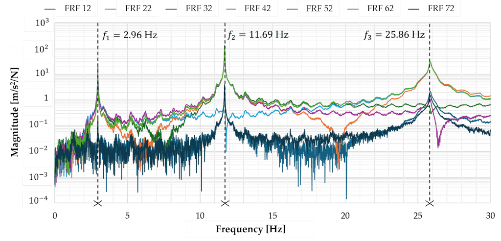

Finally, we exported the FRFs using the software tools to a Microsoft Excel spreadsheet, and Figure 9 provides a more precise representation of their magnitude (Y-axis on a logarithmic scale, m/s2/N).
Examining the magnitude plots, we identified natural frequencies by the peaks in the signals. It is imperative to note that, while the FRFs at the supports are theoretically zero since a support does not have a motion in the measured vertical direction, in practice, noisy, close to but non-zero functions are obtained (points 1 and 7).
On the other hand, phase and coherence plots depicted in Figure 8 indicate the 180° (π radians) shifts corresponding to a vibration mode (peak) at a particular natural frequency, and a perfect linear dependence between the averaged signals, respectively.
We could also consider other interesting interpretations based on the calculated FRFs, which depend on the number of peaks in each function. For example, FRF 42 only presents two peaks instead of three, since point 4 is a node in the second identified mode of vibration (see Figure 2).
That means, no amplified response in terms of acceleration or displacement occurs at that point when we apply a load in point 2 at the natural frequency, f2=11.69 Hz (see Figure 7.b). The same also applies to FRFs 32 and 52, where the peak at f3=25.86 Hz is missing, meaning response points 3 and 5 correspond to nodes, as seen in the mode shape of Figure 7.c.
Additionally, the small, non-ideal motions at the supports (points 1 and 7) result in functions with peaks of lower magnitude. We consistently made an impact at point 2 and never found that particular point to be a node in the Vibration Modes within the analyzed frequency range. That is visible in FRF 22 (DPA).
Figure 9. Exported FRF magnitude plots after EMA in DewesoftX.
