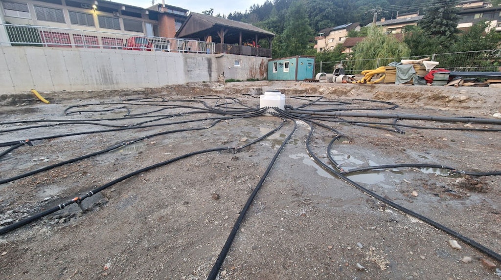

Figure 1. Top: Borehole field of the designed BTES system during construction.

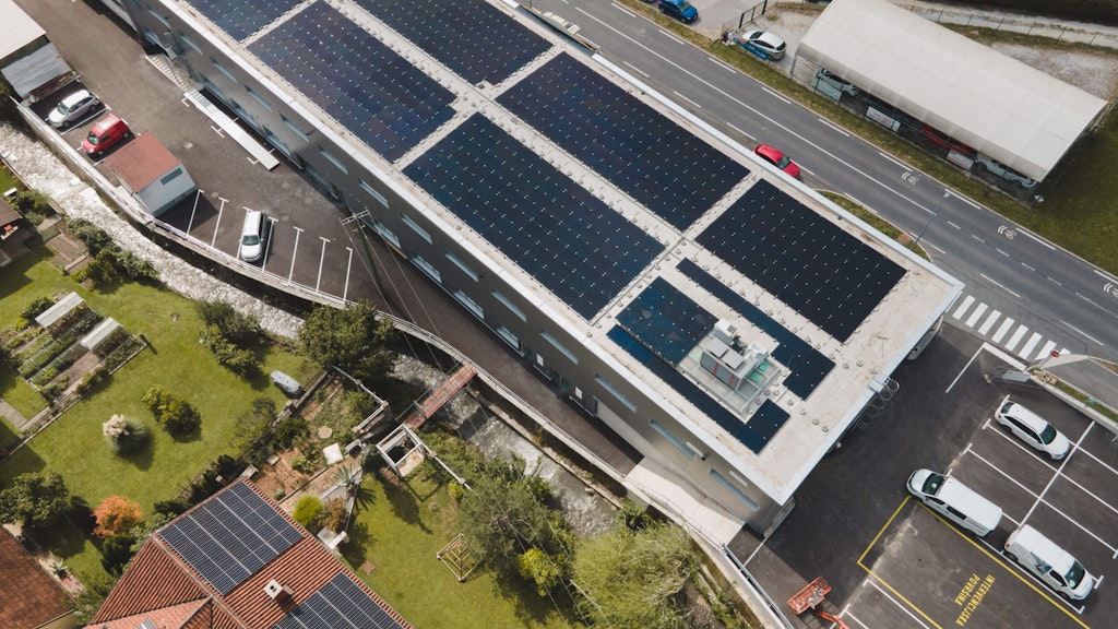

Figure 2. Aerial view of the Dewesoft production facility with the solar panels. The BTES system is below the parking in the lower right corner of the photo.

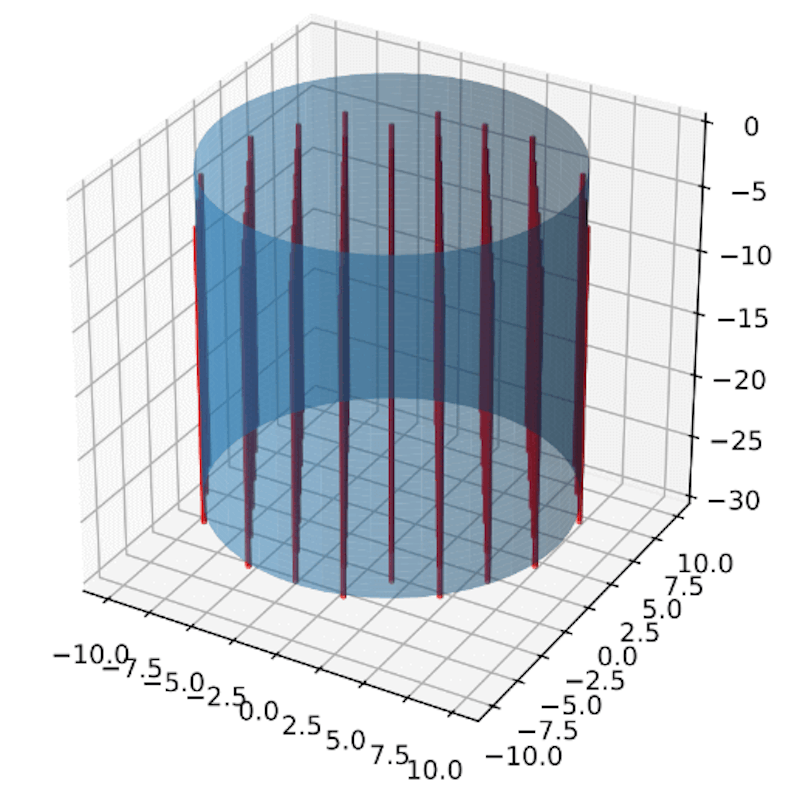

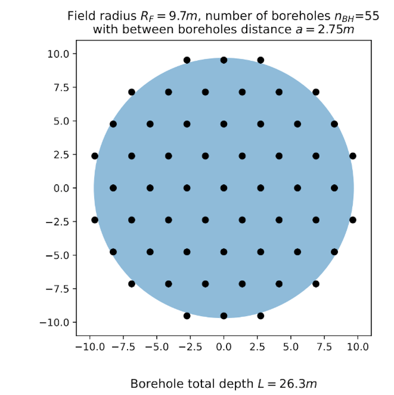

We evaluated and dimensioned the BTES thermal storage unit design through both analytical and numerical simulations. This multi-layered research approach enabled the precise validation of all key system parameters, ensuring optimal efficiency under the given operational conditions.
Layout of the borehole field of the designed BTES system in top view.
Layout of the borehole field of the designed BTES system in 3D view.
Figure 3. Layout of the borehole field of the designed BTES system in both top and 3D views.

Figure 4. The 400 m² of solar panels on the building’s roof.
The sun is a source of energy. It does not shine at night; in winter, it shines five times less than in summer. Therefore, we designed the heat pump system to operate only when the sun is shining.
The building features 400 m² of solar panels, supplying two heat pumps of 100 kW each. These panels generate all the power required to operate the pumps, which means we nearly achieve complete energy independence from the electrical grid.

  • BTES configuration: 55 boreholes, each 27 m deep
  • Piping: Total length 1500 m

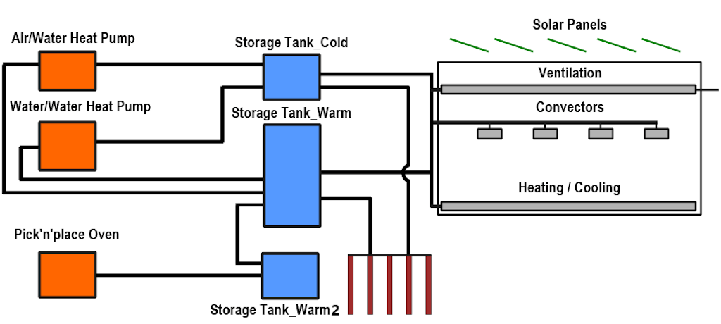

Figure 7. Schematics of the BTES system.
Our BTES system operates based on the fundamental principle of two operating modes: the first is the charging phase, and the second is the discharging phase. Both names are related to the current status of the BTES storage. The charging phase typically occurs between mid-April and mid-October, while the discharging phase characterizes the remainder of the year.
During the charging phase, we store heat. To have sufficient output energy during the heating season, we actually store more than we need, as we lose some energy, primarily through conduction in the soil. The energy we want to store is freely available when charging from solar collectors, PV, and surplus energy from air conditioners.

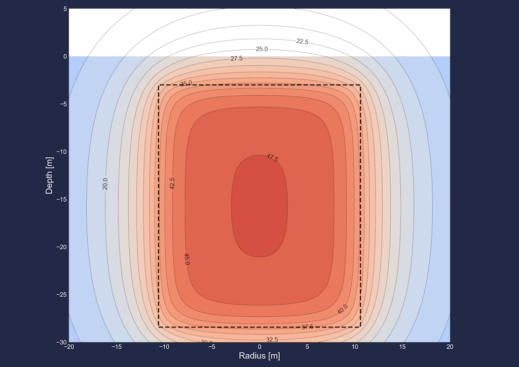

Figure 8. Storage temperatures at the end of the storing season (approx. 15th of October).
Figure 9. Storage temperatures at the end of the heating season (approx. 15th of April).

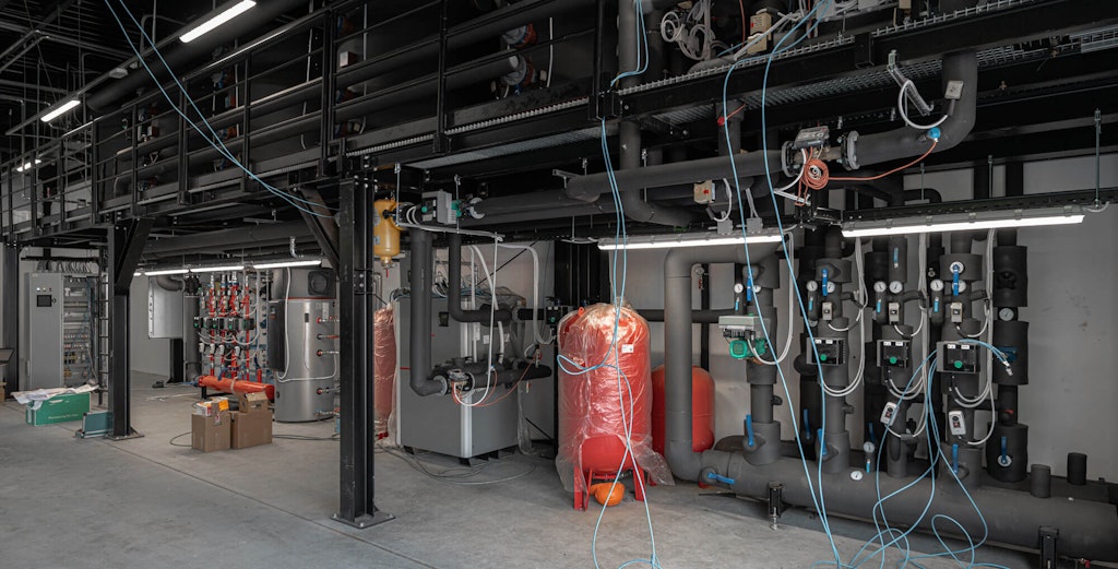

Figure 10. A view of the BTES system inside the building.

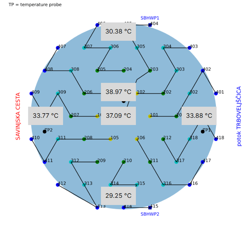

To control the storage, we measure soil temperatures at various points. For control, we use the core temperature, which is the average between temperatures measured at 10.5 m and 18 m deep at the center of the storage.
We then compare this core temperature with a theoretically calculated characteristic temperature that our storage should be at a specific time of the year. Based on the differences between those two temperatures, the control system then decides what to do.

We control the BTES via monitoring its core temperature. In Figure 11, the curve labeled “2025 by theoretical model” illustrates the core temperatures we anticipate being able to produce throughout the year, corresponding to 80 MWh of energy.
Figure 14. Status of the BTES as of 19th September 2025.
The green curve, labeled "Monitored temperature", represents the current core temperature. The other three curves are cubic polynomial approximations of where we want to be at a specific time of the year (where +1/-1°C curves present some tolerance of expectations).
Currently, we are slightly below the target temperature, approximately 0.5 °C below, but this is acceptable for the first complete year of using the BTES system.

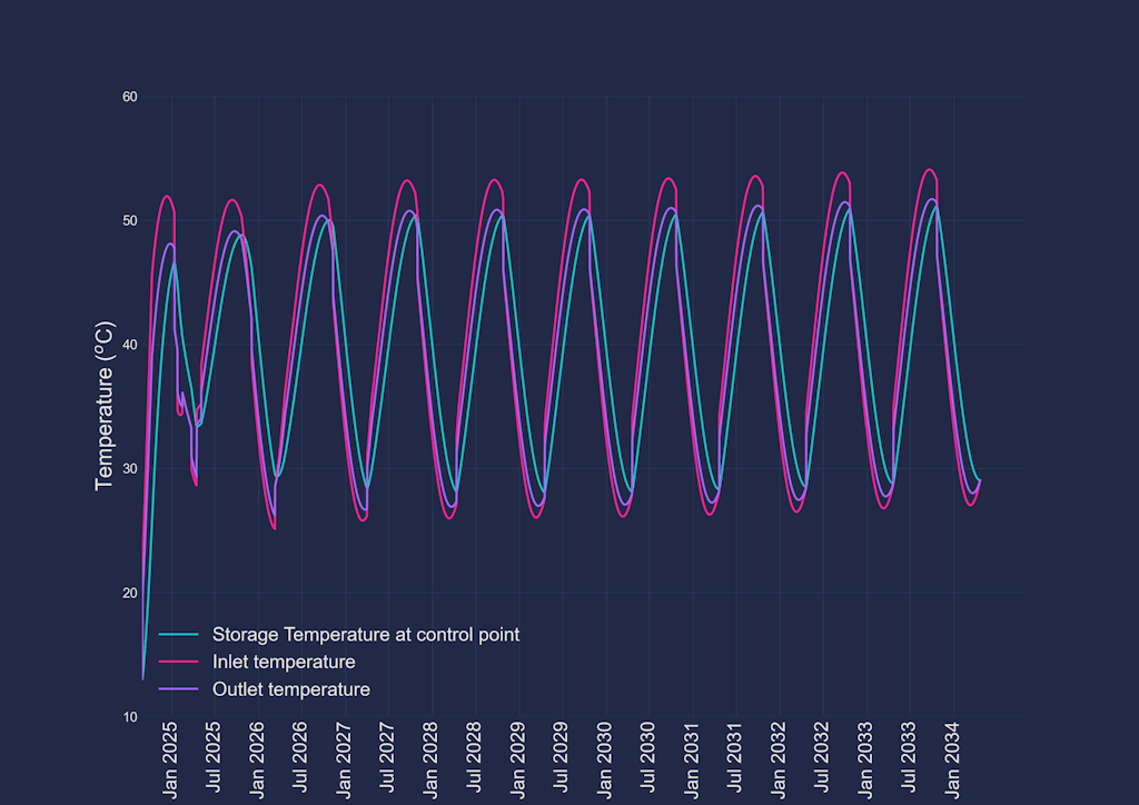

Figure 15. 10-year simulation of fluid and storage temperatures.
