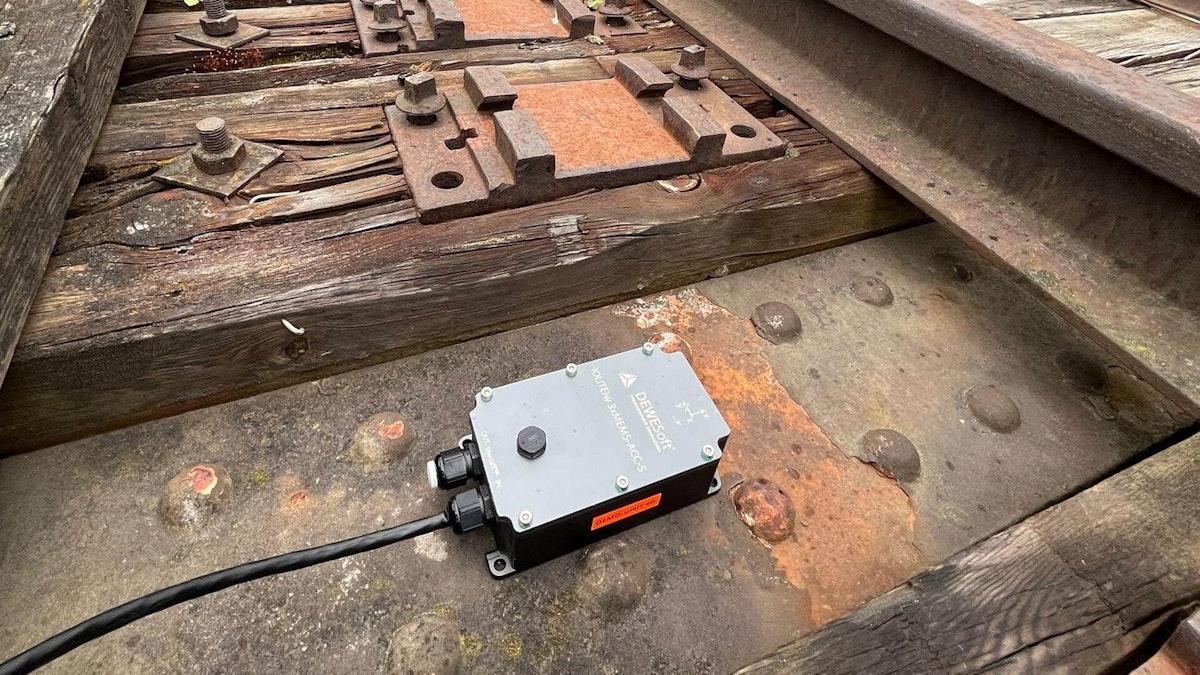

Dewesoft IOLITEi 3xMEMS measurement system
The IOLITE 3xMEMS sensors are IP67-rated, high performance accelerometers that form part of a family of data acquisition devices. They feature an embedded low noise triaxial MEMS accelerometer, analog-to-digital conversion, and an EtherCAT interface, all based on the IOLITE modular DAQ device platform.
The IOLITEi 3xMEMS sensors can measure the DC component of the acceleration field (gravity) and detect quasi-static accelerations as low as 0 Hz. The Dewesoft IOLITEi 3xMEMS-ACC devices have a very low noise performance.
The IOLITEi 3xMEMS-ACC has a 25 µg/√Hz spectral noise density while the IOLITEi 3xMEMS-ACC-S has an ultralow spectral noise density of 0,7 µg/√Hz. It is comparable to the best-in-class Force Balanced accelerometers, as shown in Figures 6 and 7. The waterproof IP67 chassis is available for all configurations and can operate over a wide temperature range from -50°C to 65°C.

To evaluate this, we compared the noise floor of the installed sensors with a new Dewesoft sensor designed for high sensitivity and very low noise performance. The Dewesoft sensor was installed on floor beam 4, closest to the north wall, as shown in the lower panel of Figure 17.
The Dewesoft sensor was then compared with the nearest installed sensors: the triaxial AG3 and the uniaxial AL11, AL12, and AL16. These sensors are highlighted with dashed magenta frames in the upper panels of Figure 17. The comparison was performed by visualizing the Power Spectral Densities (PSDs) of the collected data from both the Dewesoft sensor and the installed sensors, as shown in Figure 18.
Figure 17. The compared sensors.
Figure 18. PSD comparisons.
