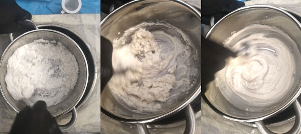

The fabrication of the KNSB-65/35 propellant begins with powder preparation: We weighed Potassium Nitrate (KN) and Sorbitol (SB) according to the desired 65/35 mass ratio. The KN is finely ground (approximately 15 seconds per two tablespoons). At the same time, the SB is used in its original granulated form, following Richard Nakka’s recommendations to control the viscosity of the molten mixture better. Both components are dry-mixed for a minimum of 3 hours to ensure a uniform composition.
The experimental cooking process begins by heating half of the dry mixture to 125 °C. The temperature is then increased to 130 °C for 3–4 minutes to accelerate the melting process, and subsequently lowered back to 125 °C once melting begins (after approximately 5–6 minutes). Once the first half has fully melted, we add the remaining dry mixture, completing the fusion process in about 12 minutes.
Compared to Nakka’s baseline procedure (110 °C for 10 minutes), our process involved slightly higher temperatures (125–130 °C). However, no visible degradation, such as discoloration or scorching, was observed, suggesting effective thermal control throughout the curing process.
In conclusion, the grain curing process was successful, resulting in the complete fusion of the KNSB mixture without any apparent degradation. Although the processing temperatures slightly exceeded those proposed by Nakka, we detected no immediate adverse effects.
Figure 2. Stages of the KNSB-65/35 propellant fusion process.

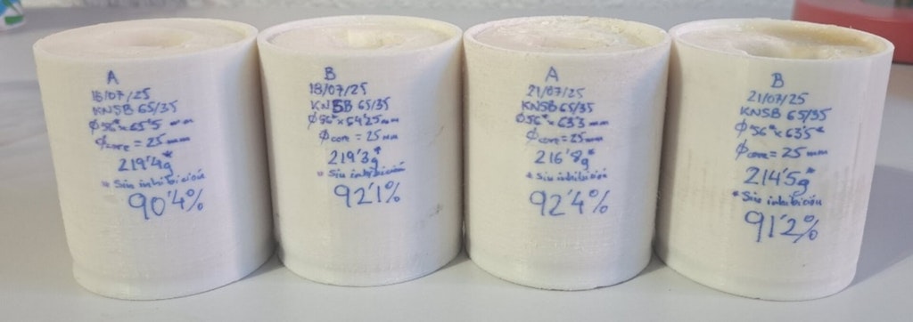

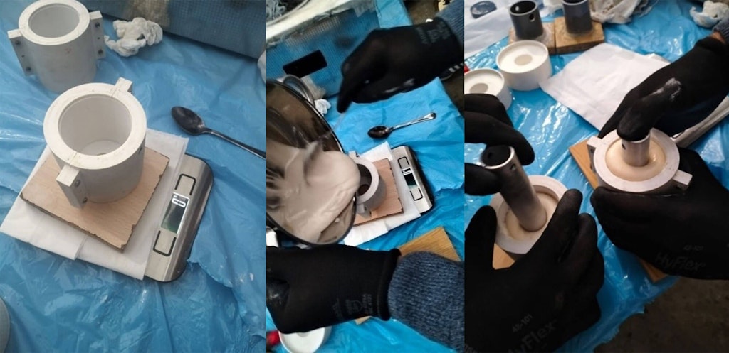

Molding and grain solidification
One of the main challenges encountered during the production process was the demolding of the solidified propellant. This step involves removing the core from the grain without deforming or damaging it, while maintaining its structural integrity, particularly by avoiding cracks that could negatively impact combustion performance.
Several tests were conducted during development to optimize this process. Initial strategies included the use of mold release agents, such as greases, applied to the core to ease extraction after solidification. Although this method reduced friction to some extent, it presented significant drawbacks: residue left on the grain surface, lack of uniformity, and potential interference with ignition or combustion.
In parallel, we evaluated different materials for the cores to assess their demolding performance. We tested cores made of aluminum, stainless steel, and Teflon (PTFE).
Among these, Teflon showed the best results in terms of clean and adhesion-free demolding. We attribute this performance to its low coefficient of friction and minimal surface energy, which reduces adhesion between the propellant and the mold. In contrast, both aluminum and stainless steel exhibited higher adhesion and required greater extraction force, increasing the risk of grain fracture.
In addition to material selection, we investigated the effect of introducing a slight taper in the core. The rationale behind this geometric modification is to reduce the tangential friction forces generated between the grain and the core walls during extraction. Theoretically, incorporating a draft angle converts part of the axial extraction force into a radial component, facilitating slippage.
We optimized this draft angle based on geometric and tribological criteria. Literature suggests that angles between 1° and 3° are effective for precision cylindrical molds. After several iterations, we experimentally determined that an angle of approximately 2° offered the best balance between ease of extraction and dimensional stability of the grain, while maintaining a suitable geometry for internal-burning configurations.
As a result of this research, the final procedure adopted by our team consists of:
  • Using machined Teflon cores with an internal taper of 2° relative to the longitudinal axis.
  • Applying uniform, gentle axial pressure during demolding, without the use of lubricants or chemical agents, thereby avoiding surface contamination of the grain.
  • Allowing for controlled cooling of the propellant before demolding to prevent internal stresses or shrinkage-induced cracking.
This optimized procedure has not only improved demolding efficiency but also significantly reduced the failure rate due to grain fracture, increasing grain lifespan and improving the repeatability of the manufacturing process.
Figure 3. Molding of KNSB-65/35 propellant.
Figure 4. KNSB-65/35 propellant grains solidified in molds.

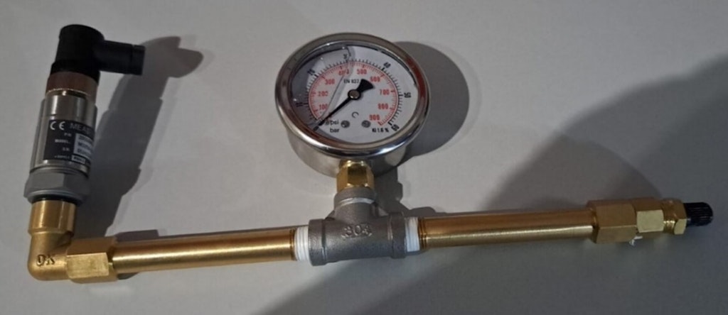

To characterize the performance of the rocket motor during static testing, we implemented a robust system to measure the pressure inside the combustion chamber. This system combined both analog and digital instrumentation to ensure accurate and reliable data acquisition.
We conducted the primary pressure measurement using an analog dial gauge connected directly to the combustion chamber of the rocket motor. This instrument provided real-time visual readings of chamber pressure during the test, enabling immediate assessment of motor behavior.

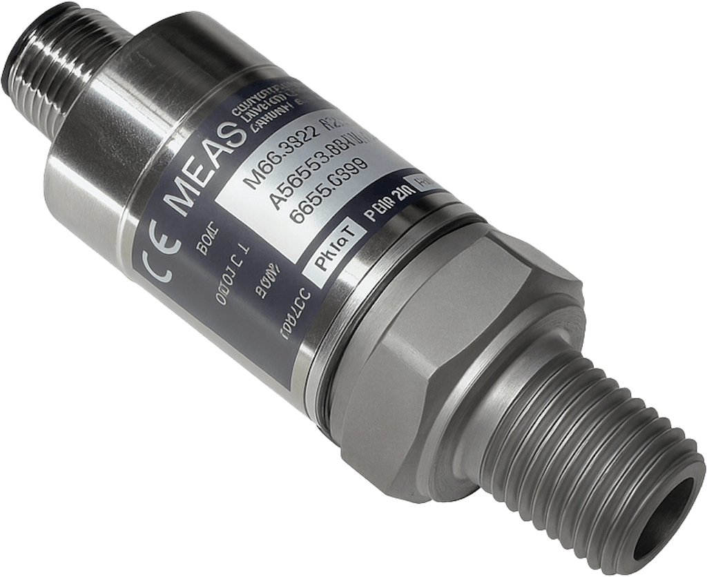

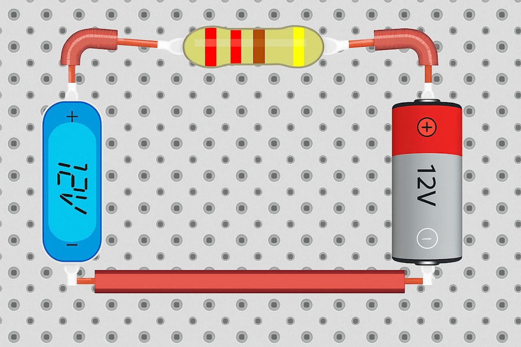

In parallel, we integrated a TE Connectivity M320D pressure sensor with the system for digital data acquisition. This pressure transducer connects to a signal conditioning circuit, designed to adapt the sensor’s output to meet the input requirements of the data acquisition system. The conditioned signal was then routed to the central data logging unit, enabling real-time monitoring and continuous recording of chamber pressure throughout the test.
 Figure 5. Pressure sensor.
Figure 6. M3200 pressure transducer.
Figure 7. Schematic of the circuit. The blue device represents the pressure sensor, and the battery on the right serves as the portable power source, supplying 12 V. On one side of the resistor is a wire that carries the signal, and on the other side, a neutral wire is present.

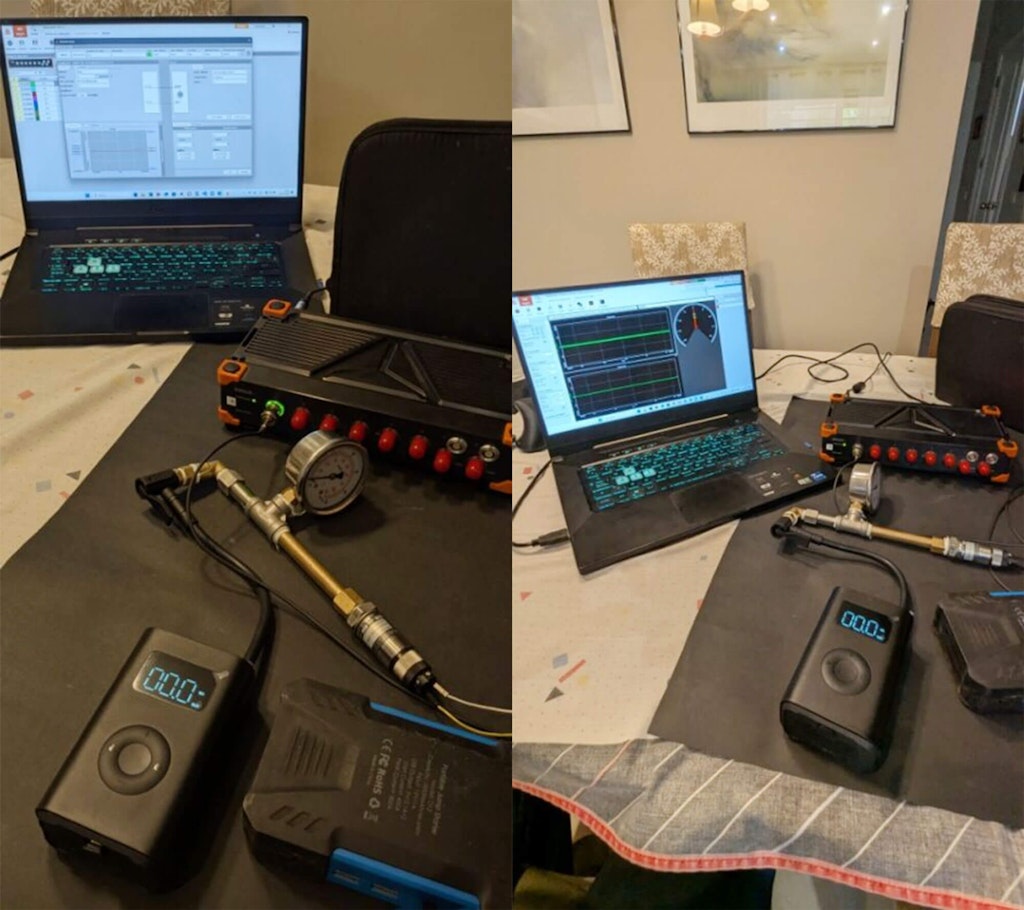

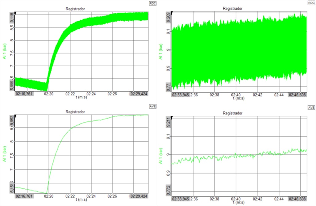

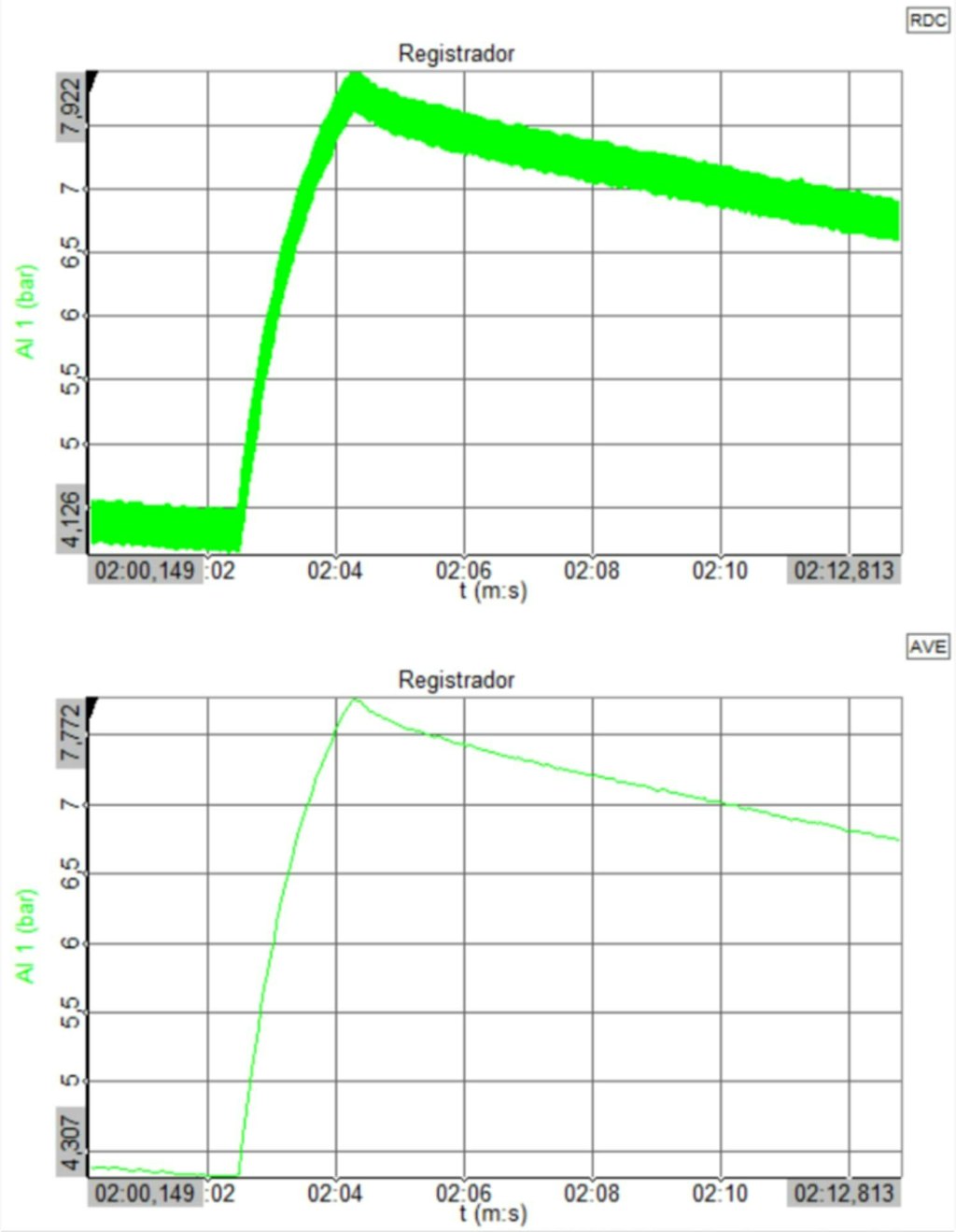

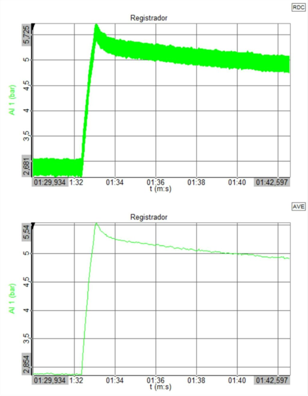

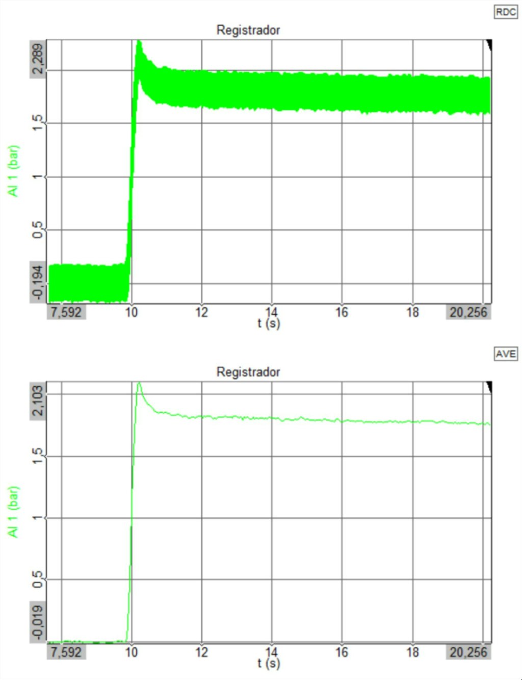

Before ignition, we performed a pressure sensor calibration procedure to verify that the system accurately received and recorded pressure data. The calibration setup involved powering the pressure sensor using an external power supply, following the wiring scheme shown in the system circuit diagram. Simultaneously, we connected the signal cable to the Dewesoft SIRIUSi acquisition unit.

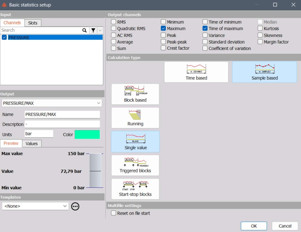

The following figures illustrate the setup implemented for this test within the Dewesoft software environment.
Figure 8. The setup implemented in DewesoftX.
We configured two mathematical channels, each represented by a digital gauge, to display the maximum pressure value and the corresponding time at which it occurs since data recording began. Figure 9 shows the configuration applied.
Figure 9. Basic statistics adjustment configuration.

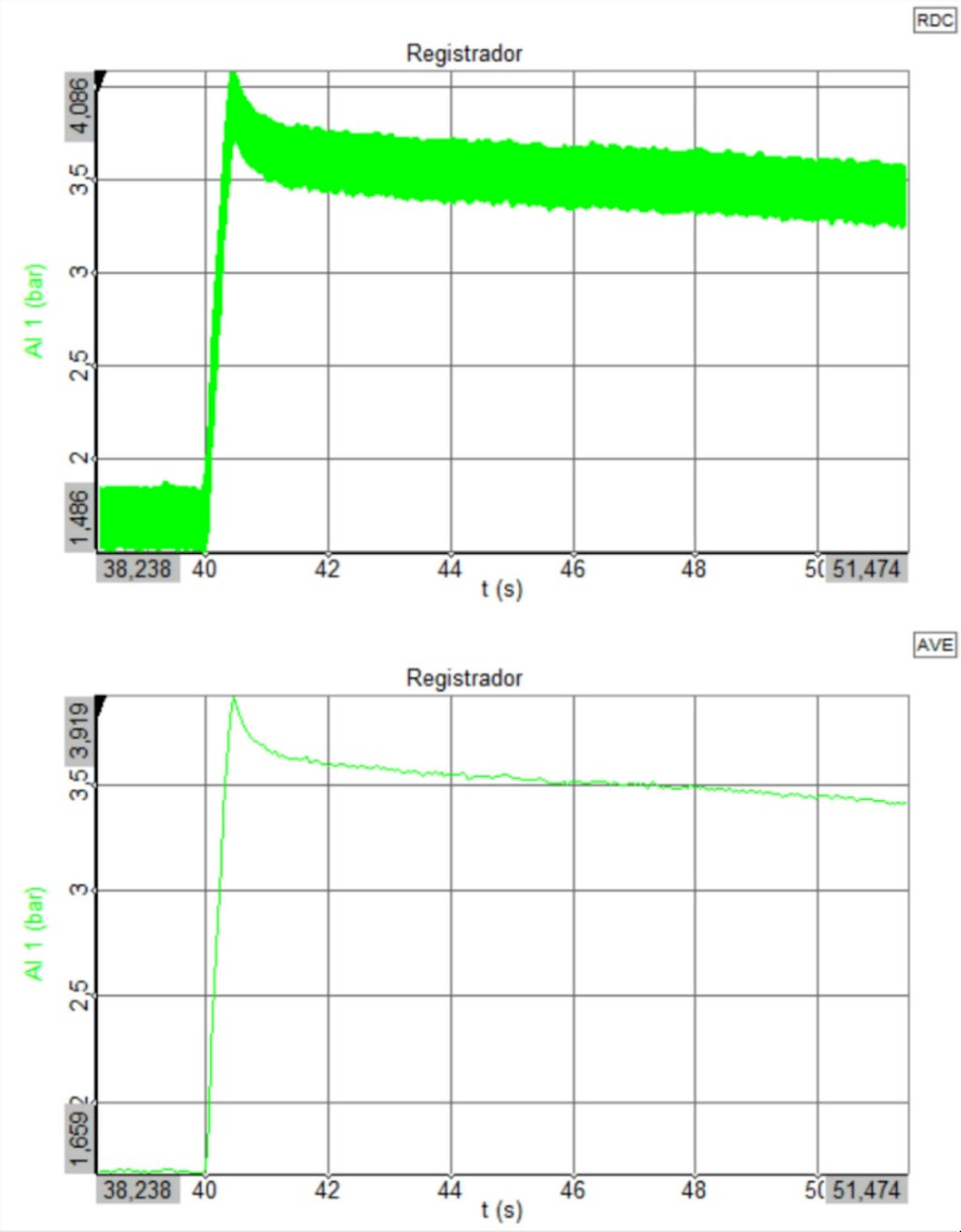

The sensor’s pressure intake, inserted through the combustion chamber closure, was connected to a manual pressure calibration device, which allowed the application of controlled pressure in bar increments.
The main goal of the calibration was to confirm that the recorded data was consistent and coherent with the actual pressure applied, as indicated by the reference device. We used multiple controlled pressure levels to test the system:
Figure 10. Measurement at 1.8 bar.
Figure 11. Measurement at 3.59 bar.
Figure 12. Measurement at 5.4 bar.
Figure 13. Measurement at 7.8 bar.
Figure 14. Measurement at 8.9 bar (the upper limit of the calibration device).
For each pressure level, we recorded both the raw signal value and the corresponding smoothed average value. This dual measurement approach allowed for immediate detection of any potential anomalies or signal instability. In all cases, we found the readings to be highly consistent with the applied pressure, and the averaged values closely matched the actual input, confirming proper sensor behavior and system integrity.
We observed minor pressure drops during each step due to internal losses within the calibration setup. Both the analog gauge integrated into the pressure sensor and the data acquisition system reflected these drops simultaneously.
Below is an image showing the complete calibration setup, with all components properly connected and the system ready for testing:
Figure 15. Calibration setup. Note the pressure sensor connects to a 12 V battery and the SIRIUSi module, which interfaces with the PC to display the pressure vs. time graph from the setup.

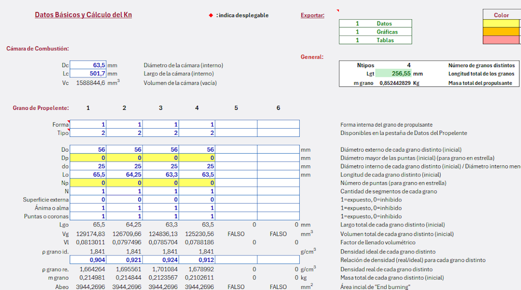

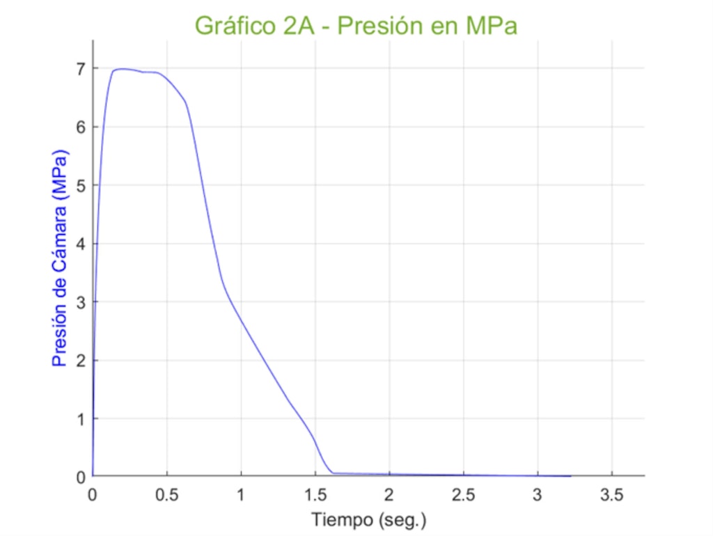

Before the static firing, we conducted a series of simulations using HERMES, the association’s in-house developed motor performance simulator. These simulations were crucial for ensuring the safety and feasibility of the test. They enabled control over key parameters such as expected chamber pressure and thrust levels, while also helping determine the optimal grain configuration for stable and predictable performance.
Figure 16. HERMES, motor performance simulator.

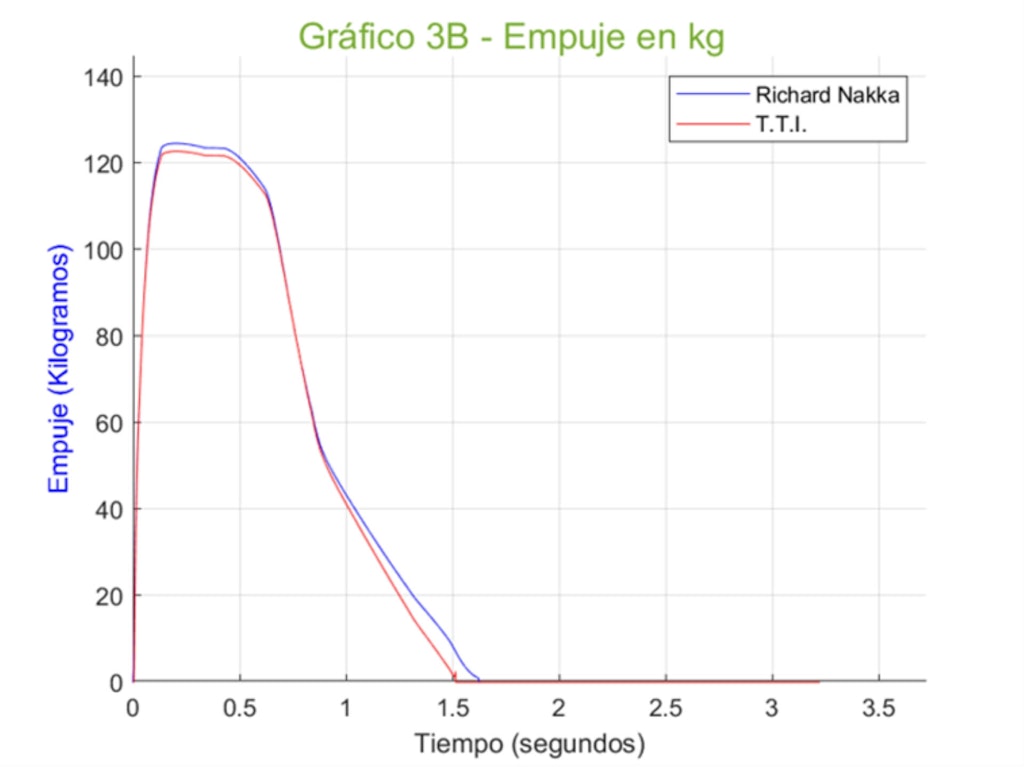

The simulations predicted the following key performance metrics:
  • Combustion duration and thrust time profile
  • Peak chamber pressure
  • Total impulse
Simulated chamber pressure (Graph 2A)
Figure 17. The ideal pressure profile.
The simulation predicts a maximum chamber pressure of approximately 7 MPa, sustained for nearly 0.6 seconds before gradually declining. The pressure drops significantly after the 1-second mark and returns to atmospheric levels by about 1.5 seconds. This pressure curve suggests a stable burn phase followed by a controlled tail-off, which aligns with expectations for this propellant formulation.
Simulated thrust profile
Figure 18. The ideal thrust profile.
The thrust simulation shows a peak thrust of approximately 125 kg, reached shortly after ignition and maintained for about 0.5 seconds. The thrust then begins to decline in a smooth, continuous manner, reaching near zero by 1.5 seconds. The simulation includes a comparison with a reference curve (Richard Nakka), showing close agreement in terms of peak thrust and burn duration. This accordance indicates that the designed grain configuration and propellant behavior closely match established performance benchmarks.
These simulations provided essential insight for setting safe operational limits and defining expectations, significantly contributing to a controlled and successful test campaign.

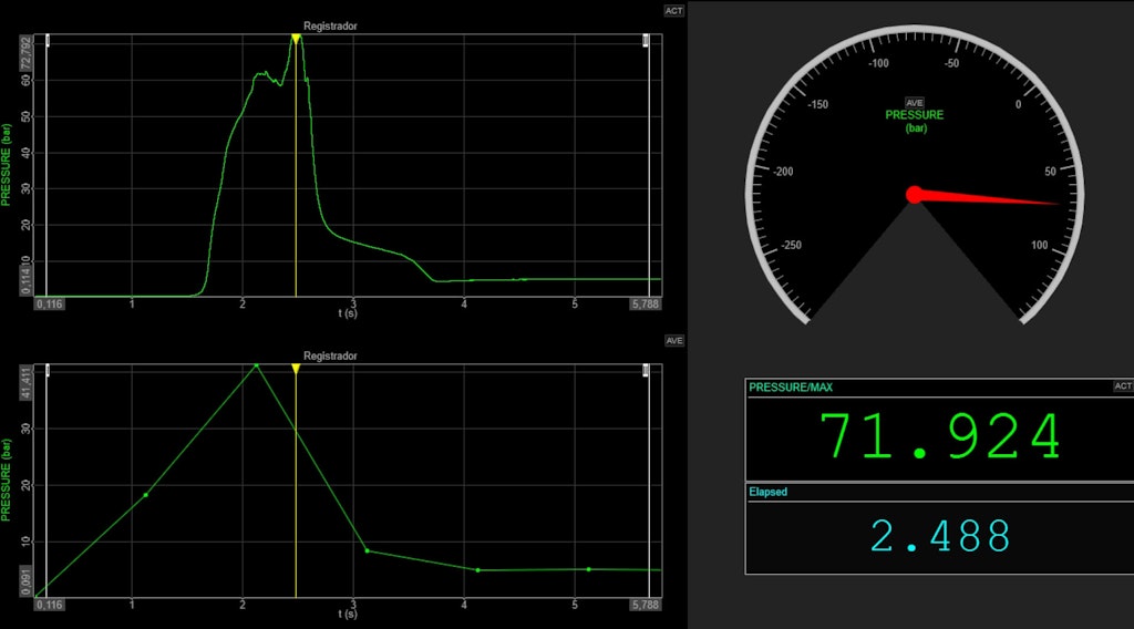

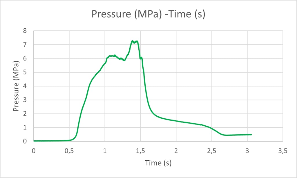

Chamber pressure – real vs. simulated
Figure 19. The real pressure profile.
The graph shown in Figure 16 presents the real-time chamber pressure data captured by the pressure sensor during the NAOS EVO motor static firing test.
Compared to the simulated pressure profile, which predicted a peak pressure of approximately 7 MPa sustained for 0.6 seconds, the real data exhibits the following key characteristics:
  • Initial pressurization begins approximately 0.45 seconds after launch, with a steep and continuous rise in pressure.
  • A first plateau is observed at around 6.1 MPa between 0.9 s and 1.1 s, followed by a secondary pressure rise peaking near 7.2 MPa at approximately 1.35 s, which slightly exceeds the predicted maximum.
  • After the peak, pressure drops rapidly, with a steep descent lasting until approximately 1.7 seconds, followed by a more gradual tail-off toward ambient conditions.
  • Some irregularities and oscillations are noticeable in the peak region, possibly due to combustion instabilities or transient effects during grain regression and nozzle flow.
These deviations from the simulated profile, especially the dual pressure peak, could be attributed to:
  • Slight variations in grain geometry or combustion surface evolution.
  • Local differences in burn rate due to uneven sorbitol distribution or voids.
  • Measurement noise or signal reflections, although the calibration process previously confirmed the sensor's accuracy.
Despite these variations, the overall shape and duration of the combustion phase closely match the simulation, confirming the validity of the model used in HERMES. The results also indicate a successful ignition and stable motor operation, reaching the design pressure safely.

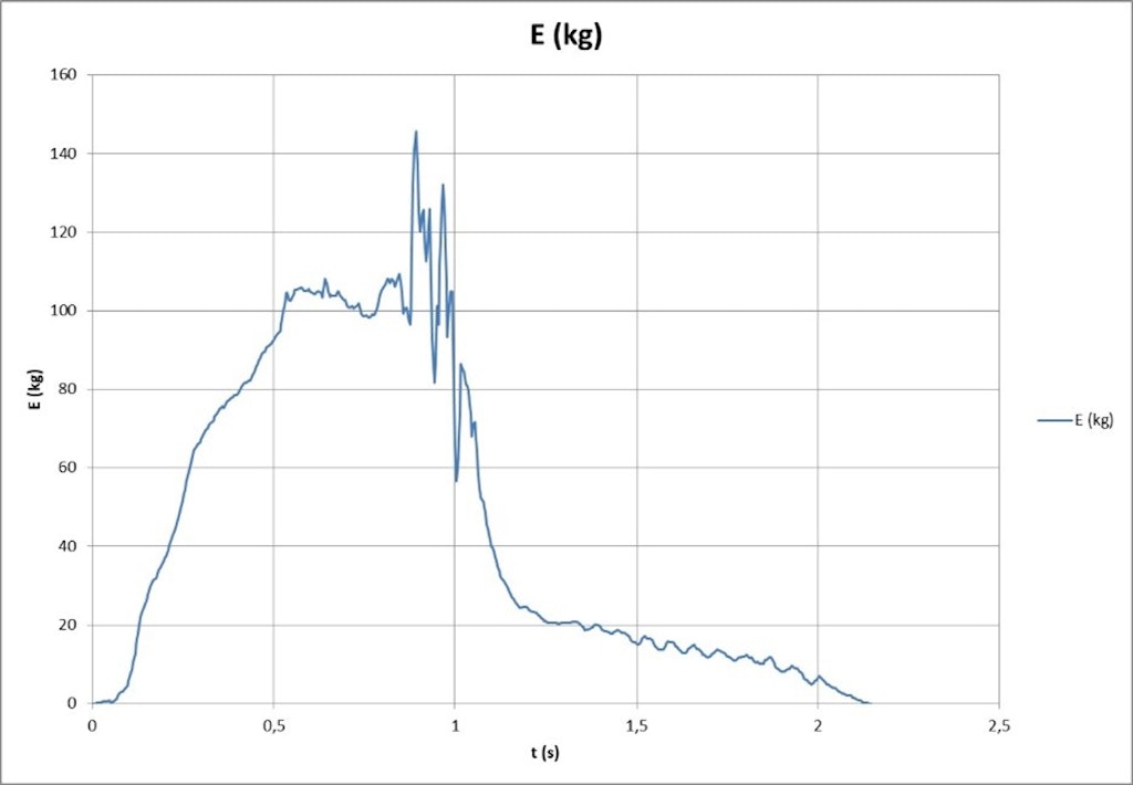

The thrust data was collected using a load cell connected to an independent data acquisition system, separate from the Dewesoft SIRIUSi. While useful for a general estimation of motor performance, this system lacks the precision and resolution of the primary pressure acquisition setup. It is therefore considered of secondary importance for this study.
Figure 20. The real thrust profile.

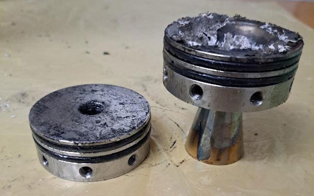

Post-test inspection

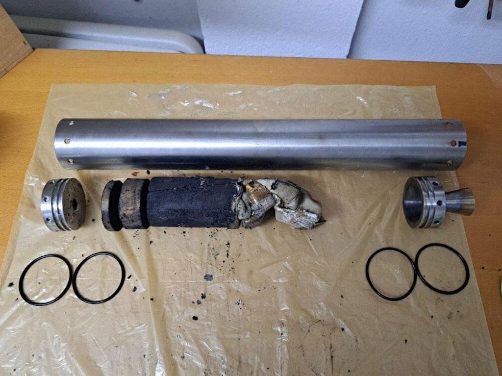

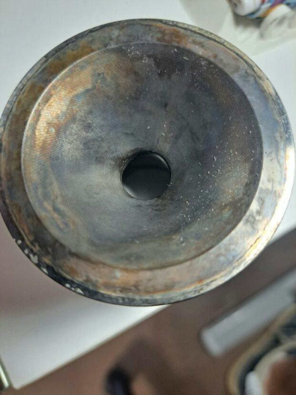

We conducted a thorough post-test inspection to evaluate the condition of the combustion chamber assembly, including the closure system and nozzle. The following images document the state of the components after the firing.
The results show that both the chamber and its structural components remain in excellent condition and are fully reusable for future test campaigns. We observed no significant damage or deformation.
The only noticeable alteration occurred in the nozzle throat. There, we detected a slight reduction in diameter (on the order of millimeters). We attributed this erosion to material ablation caused by exposure to extremely high temperatures, estimated to have reached approximately 1600 K during peak combustion.
Moreover, the rubber sealing rings (black bands) are intact and undamaged, maintaining their elasticity and sealing function. At the same time, the internal wooden spacer block, used to reduce chamber volume, retained its original dimensions and showed no signs of deformation or charring.
Overall, the chamber demonstrated robust structural integrity and thermal resilience, and we expect it to withstand multiple future firings without requiring major refurbishment.
Figure 21. Closure system and nozzle.
Figure 22. The chamber.
Figure 23. The nozzle.

Therefore, we will implement improvements in the grain manufacturing process, with a focus on developing new demolding techniques. Proposed solutions include using a non-adhesive tape on the piston to facilitate extraction, especially for cylindrical grains. Nevertheless, we have already initiated a dedicated research plan to improve manufacturing.
This firing test was the first of many planned tests. The established test plan for sorbitol will continue in parallel with the manufacturing enhancements, aiming for continuous performance improvements and maximum efficiency over time.
Furthermore, to fully leverage the capabilities of the data acquisition system, most of the propulsion department will focus on conducting offline simulations. These will enable more detailed analyses and advanced post-processing capabilities beyond what we achieved during the initial tests.
