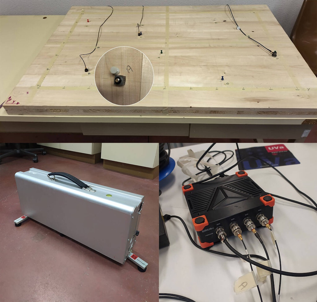

By connecting the accelerometers to the Dewesoft SIRIUS Mini data acquisition equipment (DAQ) and using the software ‘DewesoftX’, we recorded the system’s vibration response in both the time and frequency domains. Figure 2 illustrates the measurement chain.
Figure 2. Measurement chain, consisting of accelerometers, an impact machine, and data acquisition equipment.

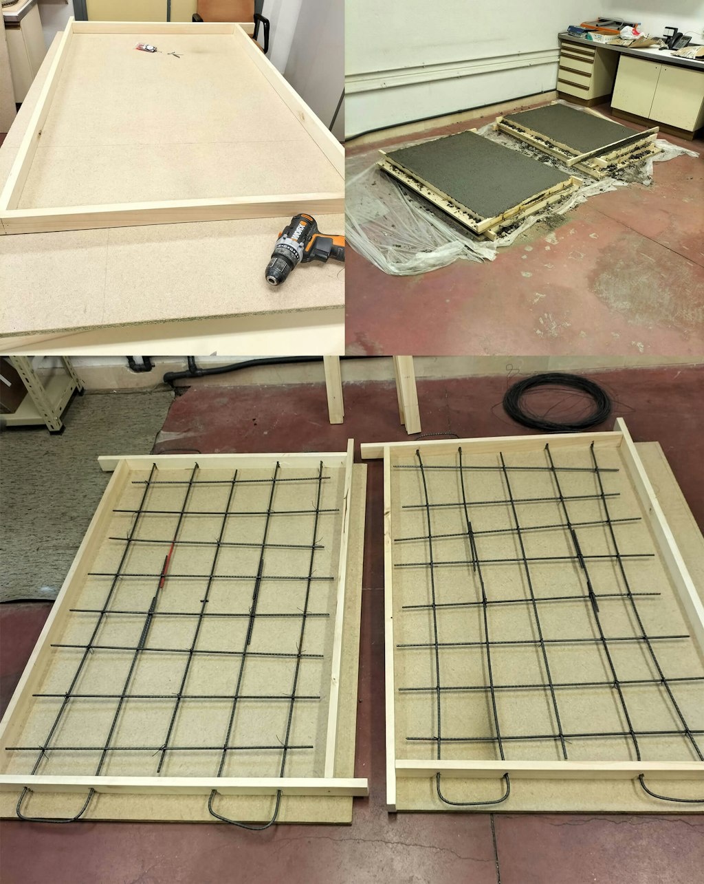

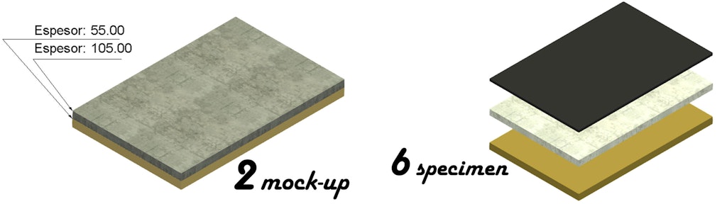

To define this methodology, we used two mock-ups: a ‘standard mock-up’ and an ‘NFU mock-up’, measuring 120 cm (±1 cm) x 80 cm (±1 cm) and weighing 102.1 kg and 85.7 kg, respectively. These mock-ups consisted of various elements (see Figure 3).
Firstly, we used a 55 mm-thick cross-laminated timber (CLT) board made of poplar. Secondly, we used two types of concrete slabs, which distinguish these two mock-ups. Finally, we applied up to three layers of ‘End-of-Life Tires’ (NFU) as a lining, with thicknesses of 4 mm, 10 mm, and 20 mm.
Figure 3. The elements that make up the mock-ups and samples include CLT board, concrete slab, and linings.

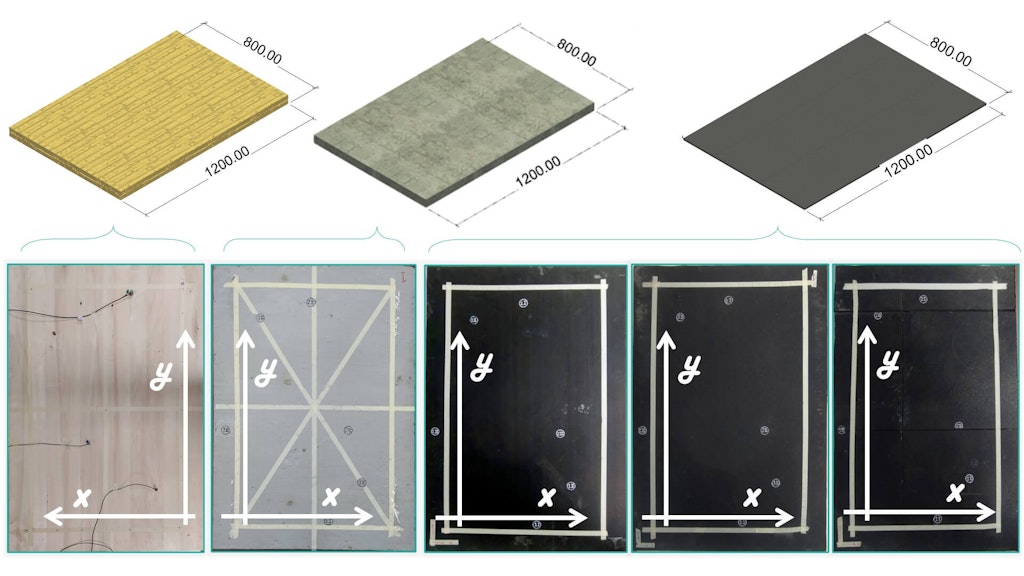

We created a total of six different specimens, combining the CLT board, the two slabs, and the three linings (see Figure 4).
Figure 4. Illustration to distinguish the concept of ‘mock-up’ from ‘specimen’.
Concerning the concrete, one of the mock-ups has the appropriate dosage to achieve ‘H25’ strength concrete, known as the ‘standard slab’. The second slab consists of NFU grit, which replaces part of the sand normally used (known as the ‘NFU slab’). Figure 5 shows images of the formwork process, concrete reinforcement (with 6mm B500S steel rods), and the final result of the slabs, with the concrete still fresh.
Figure 5. Manufacturing of standard and NFU concrete slabs.

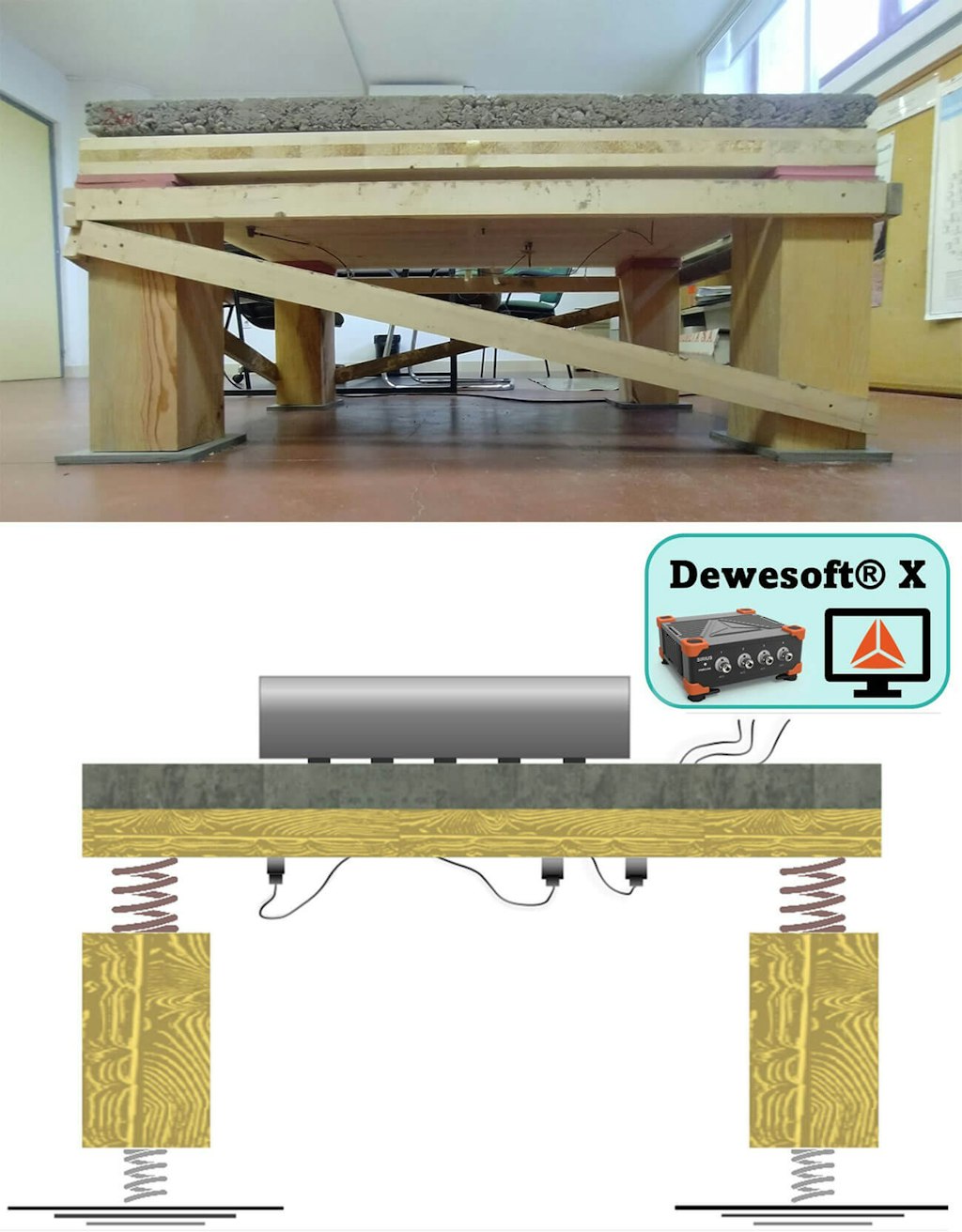

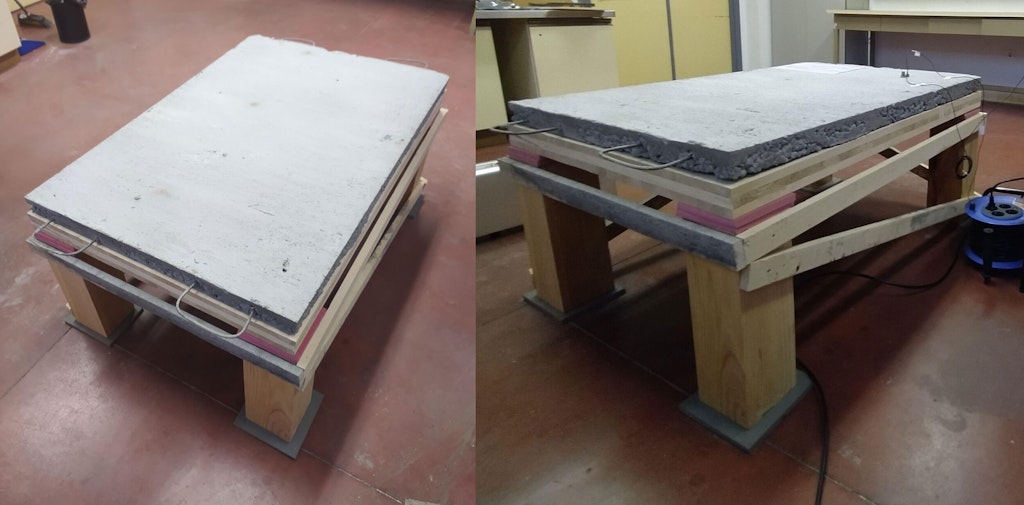

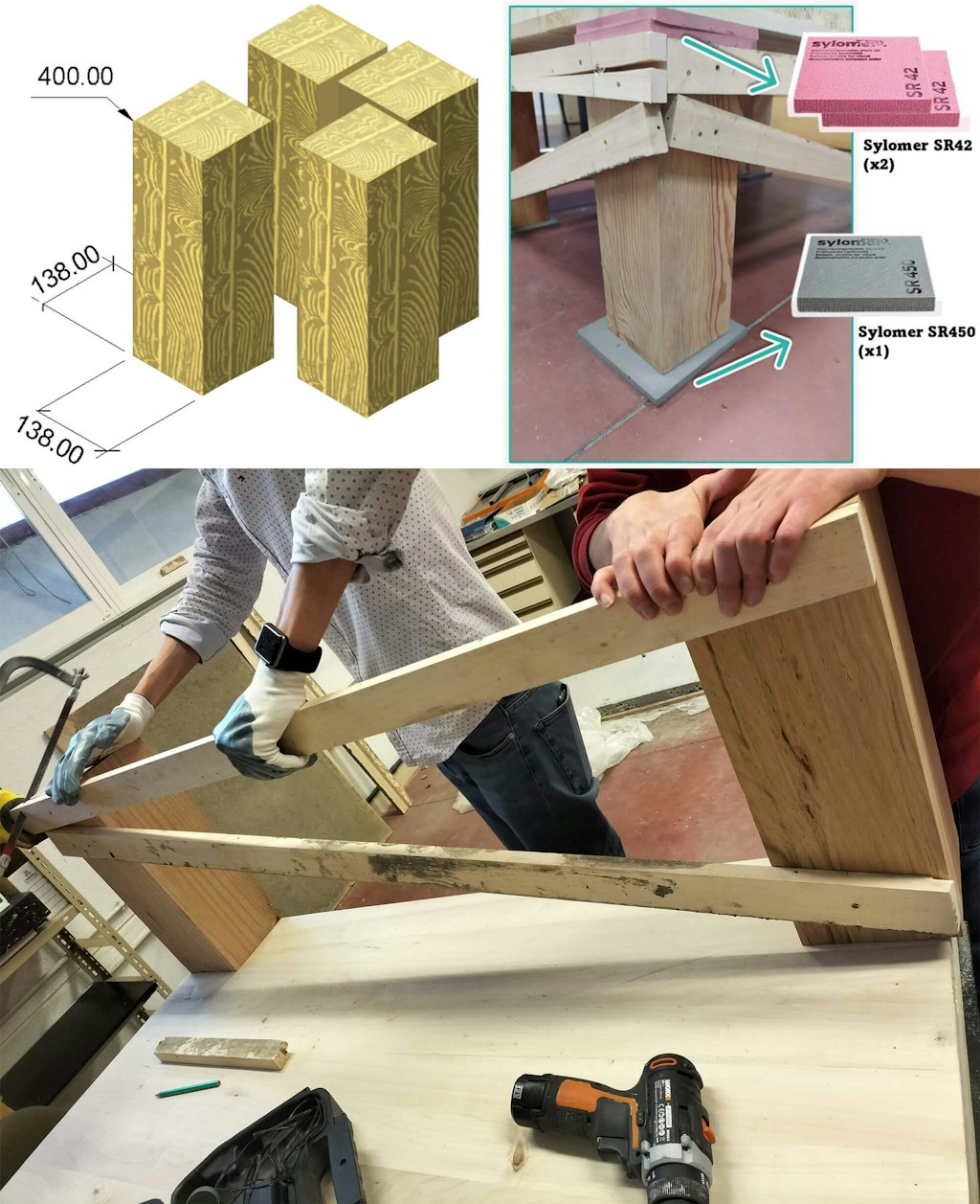

These mock-ups rest on wooden supports located at their four corners, measuring 13.8 cm x 13.8 cm. We arranged the wooden slats horizontally to join these supports, along with additional slats that join them diagonally to reinforce the system and restrict movement.
Finally, up to three ‘Sylomer®’ anti-vibration elastic plates have been placed on each support to decouple the mock-up/specimen from the environment. These plates are resistant to loads of up to 1000 t/m² [4], a factor to consider when placing weighty concrete slabs on top of CLT boards. Figure 6 shows the aspects described in this paragraph.
Figure 6. Manufacturing of the support structure, made up of supports, anti-vibration material, and wooden slats.
Figure 7 shows the final assembly of the support structure with one of the completed mock-ups, along with an illustration detailing the elastic supports created by the plates above, as well as the arrangement of the measurement chain in the test.
Figure 7. Support structure with one of the mock-ups (left), as well as an illustration summarizing the measurement process (right).

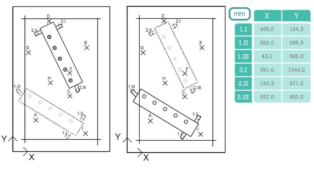

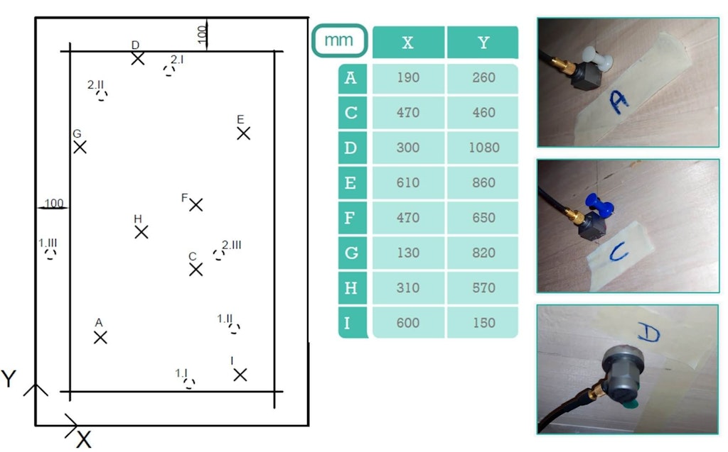

Figure 8. Selected positions to place the accelerometers in the CLT board, in addition to an image of the three employees.
As mentioned above, vibration levels (dBre10-6 m/s2) are determined using small, single-axis piezoelectric accelerometers manufactured by ‘Brüel & Kjær’, placed in three random positions on the underside of the CLT board (points a, c, and d). The letter ‘b’ is reserved to indicate the background noise measurement. We have marked up to eight positions for future measurements, and they have been placed, leaving a 10 cm space from the perimeter of the mock-up (see Figure 8).
The transducers’ wires have been attached to the board with masking tape, as they can interfere with the measurement if they move, and have been adhered to the surface using beeswax. This firm fastening does not introduce damping and does not significantly affect the reduction of the bandwidth due to poor fastening, as indicated in the Dewesoft ‘Vibration Measurement’ course [5].

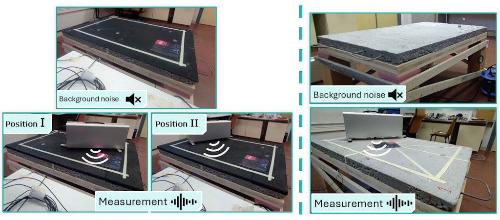

The impact machine, which causes disturbance by imitating a ‘tapping’ motion, must be placed in two positions on the specimen, locating the hammers that generate the mechanical excitation within the previously established perimeter (see Figure 9).
Figure 9. Selected positions to place the impact machine in the concrete slabs or linings.

However, we had to correct these measurements by eliminating background noise. Therefore, for each specimen, we made a background noise measurement with the lining in place and the impact machine turned off. With the lining and the impact machine turned on, we took two measurements at two disturbance positions (see Figure 10).
In addition, we must measure the acceleration level experienced by the two mock-ups (slab with CLT board, without the lining). The parameter that expresses the insulation we achieve is the difference in levels. In this way, this difference of levels (with and without the lining) is obtained in third-octave bands, in each accelerometer, ‘a’, and in the two disturbance positions ‘t’: ΔLt, a. Finally, we calculate the spatial average (accelerometers and impact machine positions) of this parameter, obtaining ΔL in each band.

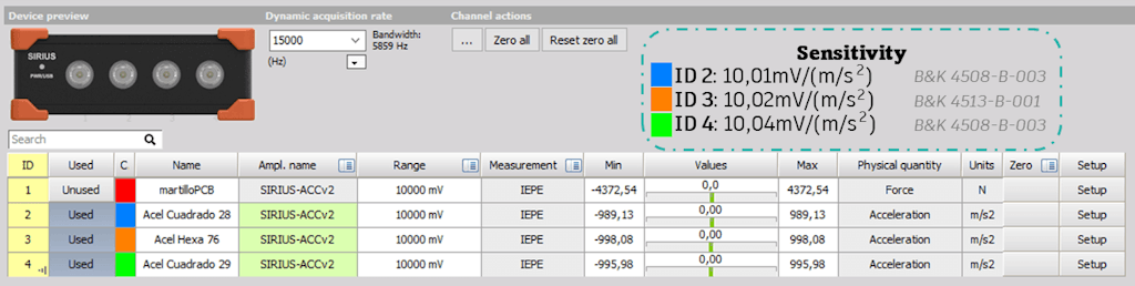

After clarifying the parameters of interest and the measurement cycle, we establish the connection between the three accelerometers and the data acquisition equipment, and configure the software ‘DewesoftX’ as shown in Figure 11. Thanks to the TEDS connection, the three channels automatically recognize and set the configuration required by each accelerometer.
The dynamic acquisition rate is 15 kHz, which means that the maximum frequency the system can measure is half this value, 7.5 kHz. Considering that we use an anti-aliasing filter, the bandwidth ultimately becomes 5859 Hz.
Figure 11. Connection of the accelerometers in SIRIUS Mini from DewesoftX, along with their sensitivity.

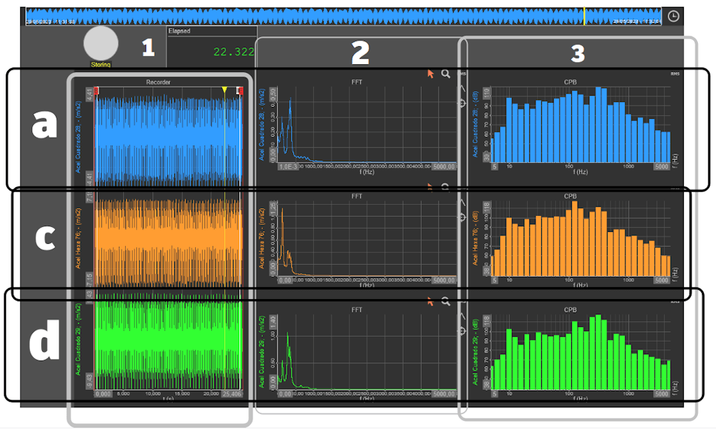

For this study, we mainly use the ‘Octave Analysis’ submodule, found in ‘Math’, to calculate (using ‘formula’ in the software) and export the acceleration level in third-octave bands, based on the acceleration measured by the accelerometers. On the other hand, one of the advantages of the software is that it can analyze data in frequencies.
Thus, we prepared the ‘FFT Analysis’ module in case, in a future study, we need to analyze the resonance frequencies of the system. In any case, it is useful to see the fast Fourier transform when collecting measurements, as it can provide information on their consistency. We use a total of 1024 lines, representing the system’s maximum amplitude (‘Peak Amplitude’) every 7.32 Hz on a linear graph, and we apply a ‘Transient’ window.
Another great advantage of the software is its ability to display the measurements taken. It allows you to customize the appearance of the dedicated tab simply and intuitively, with a wide variety of widgets. To view the results, we use time recorders that display the acceleration measured by the transducers, as well as 2D graphs to visualize the frequency spectrum (FFT Preview) and the octave graph (Octave Preview).
Additionally, we utilize an ‘indicator lamp’ to indicate the measurement storage, and a ‘digital meter’ to display the measurement duration. Figure 12 illustrates the design for data collection, where each row represents an accelerometer (a, c, d) and observes the three types of widgets mentioned for each case (1, 2, 3).
Figure 12. The Measure tab in DewesoftX for measurement and data acquisition.
