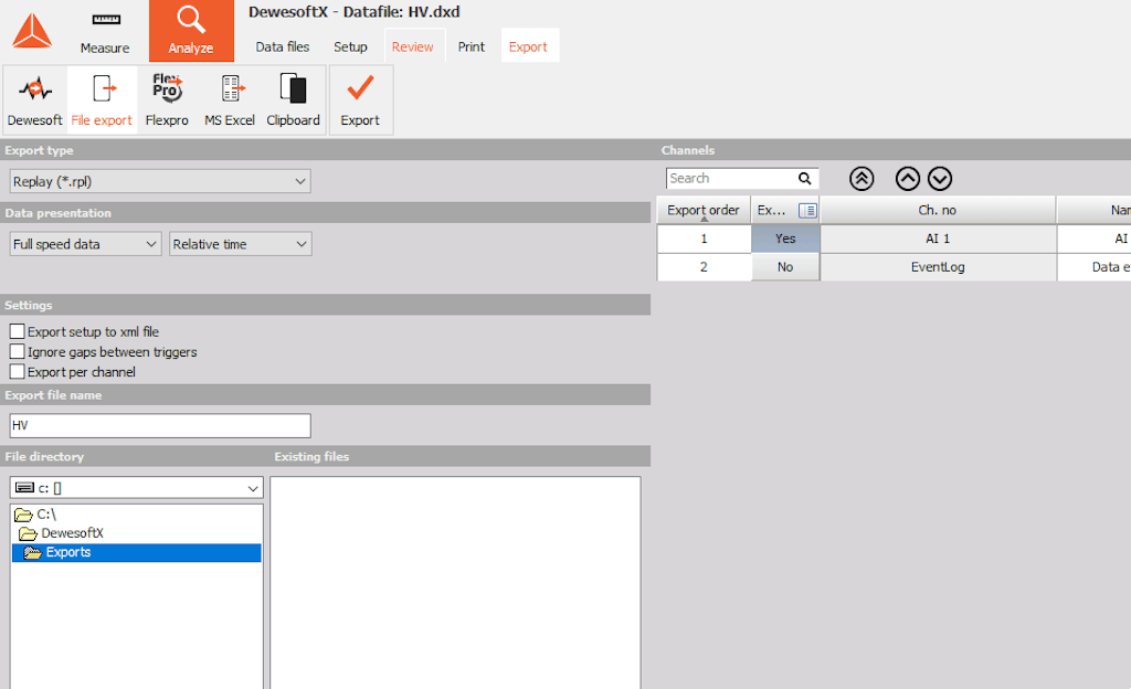

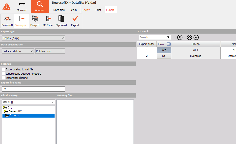

Convert a data file to the .rpl format
The ReplayFile mode requires that the data be converted to the .rpl format. Once the plugins are installed, DewesoftX .dxd data file can be converted to the .rpl file format. This process is shown below:
Figure 24 - converting DXD to RPL
