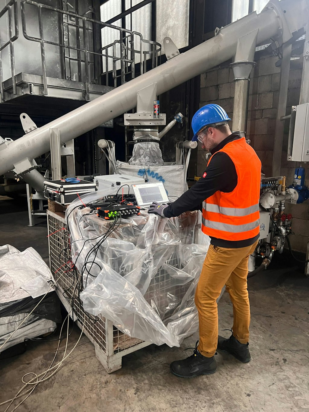

We conducted the data acquisition using a 16-channel Dewesoft SIRIUS-HD unit (Figure 1) in conjunction with industrial acceleration sensors, which have a sensitivity of 0.1 V/g.
Figure 1. Set up of the data acquisition Dewesoft SIRIUS-HD inside the facility.

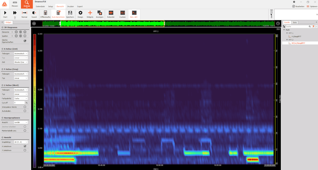

The recorded data were analyzed in the frequency domain using a Fast Fourier Transform (FFT) algorithm (Figure 2) in real-time with DewesoftX data acquisition and signal processing software. Three of the eight units exhibit elevated vibration emissions within a frequency range of 5 Hz to 9 Hz, which at times reached perceivable levels at the receiver locations.
Figure 2. Spectrogram of a representative measuring point in the foundry over 20 minutes.

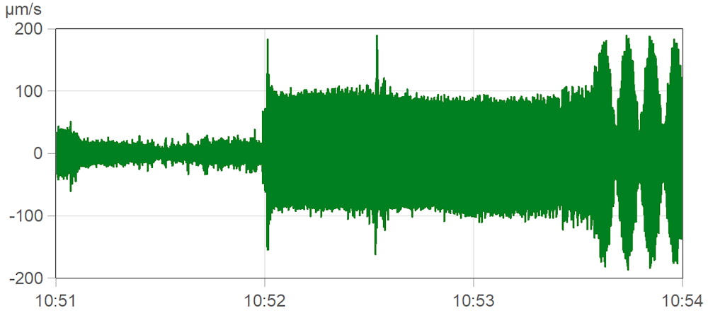

Two of the production units created vibrations at slightly different frequencies, approximately 8.72 Hz and 8.87 Hz, resulting in a modulated waveform with a period of roughly 6.5 seconds (Figure 3). Engineers refer to this effect as beating. Peak values of the modulation exceeded perception thresholds at receiver locations.
Figure 3. Example of a measured waveform with only one production unit operating and with two units operating.
Based on these findings, individual contributors as well as the excitation mechanism were identified and pointed out to the client.

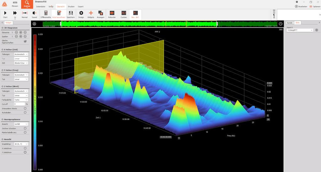

We used a three-dimensional visualization of the spectrogram (Figure 4) to demonstrate the correlations to the customer in real-time.
Figure 4. 3D spectrogram of a representative measuring point in the foundry during 20 minutes.
