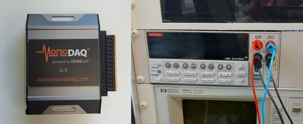

MonoDAQ is a compact, multifunctional USB data acquisition (USB DAQ) device. Our initial approach to creating a new measurement setup was to use the MonoDAQ alone. Still, this device is incapable of accurately producing such low currents, and we found no solution to process the results automatically in the data acquisition and digital signal processing software, DewesoftX.
We then decided to use a Keithley Source Measure Unit (SMU) to generate the currents and sense the voltages, a MonoDAQ to monitor the pressure, and a Python script to process and save the data, as well as interface with the user.
Keithley's Standard Series 2400 SMU Instruments offer four-quadrant precision voltage and current source/load coupled with measurement.

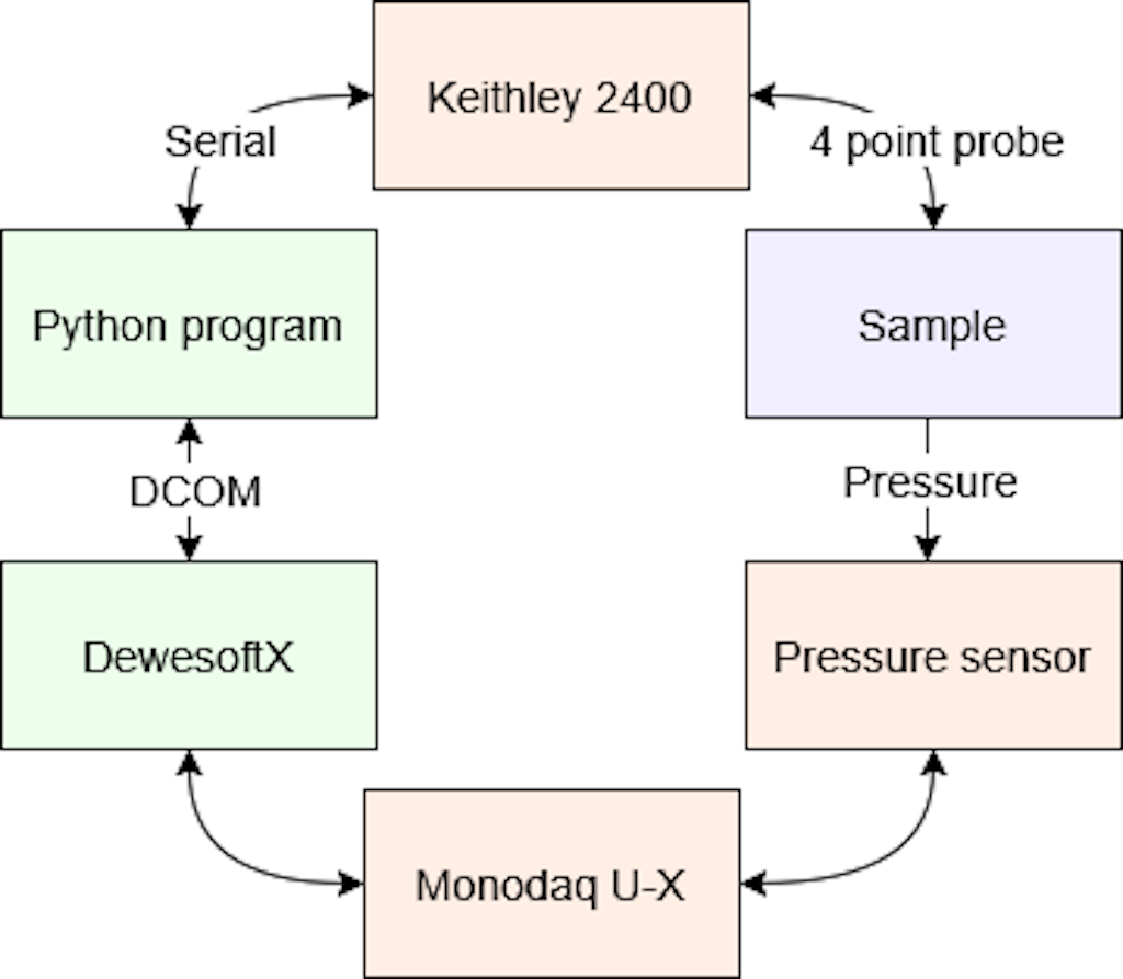

To address these issues, we implemented a new measurement setup:
  • A Keithley 2400 Source Meter, controlled by a Python script, was introduced to automate electrical measurements.
  • A MonoDAQ U-X module was used along with DewesoftX to measure and regulate the pressure applied by the probes, ensuring consistent pressure across all samples.

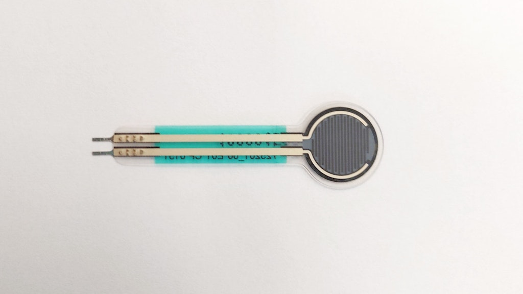

Figure 1. The force sensor used.
We used a Force-Sensing Resistor (FSR) to measure the pressure applied; however, this type of sensor is not well-suited for this application. Changing to another technology would only require changing the DewesoftX setup file, so we decided to use this sensor and simulate the pressure.

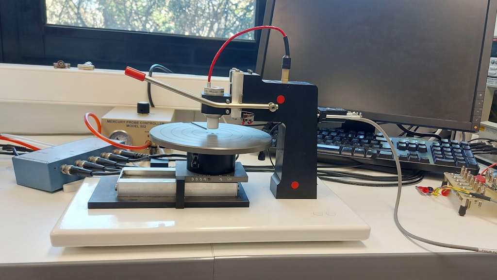

Figure 2. The multi-position wafer probe stand.

  • Jandel multi-position wafer probe stand,
  • Jandel cylindrical four-point probe head,

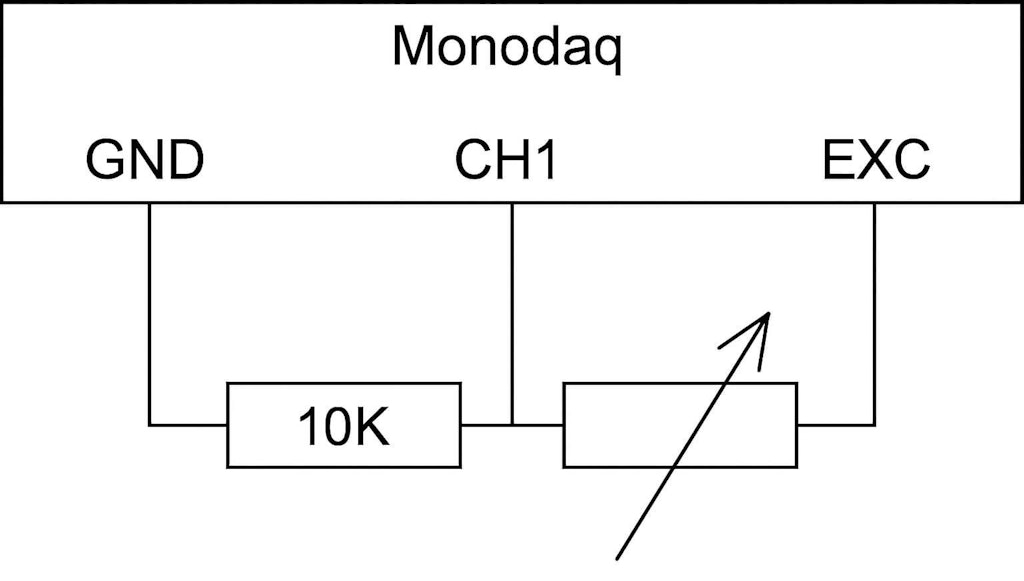

The first step was to read the pressure sensor using the MonoDAQ. The pressure sensor used is a force-sensing resistor, whose resistance decreases as the pressure increases. To measure the resistance, we use a simple voltage divider.
Figure 4. Wiring of the pressure sensor.
The DewesoftX setup file permits the easy processing of the sensor’s output outside the Python script. As the sensor is temporary, the output is only the measured resistance of the sensor.

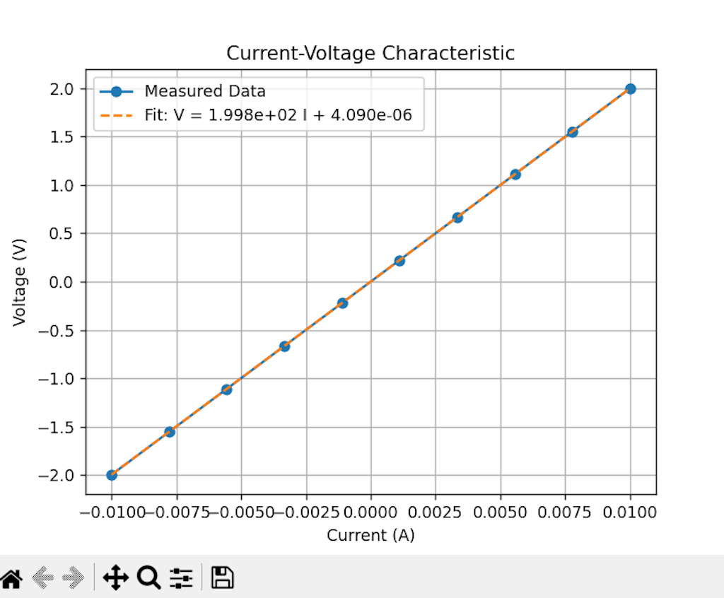

The next part was to process and save the data. When plotting the voltage against the current, the slope is the resistance of the sample.
Figure 5. Measure of a 200-ohm resistor.
This resistance can be verified by measuring known resistances. The resulting graph should be a straight line passing through the origin.

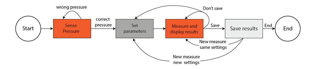

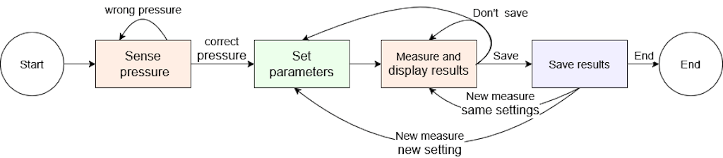

The final part of the project involved integrating all functions into a single Python script. This script was designed as a state machine, allowing for easy modification of features without requiring a complete rewrite of the code each time. This approach not only streamlined the process but also made the system more adaptable to future changes and improvements.
Figure 6. Diagram of the state machine.

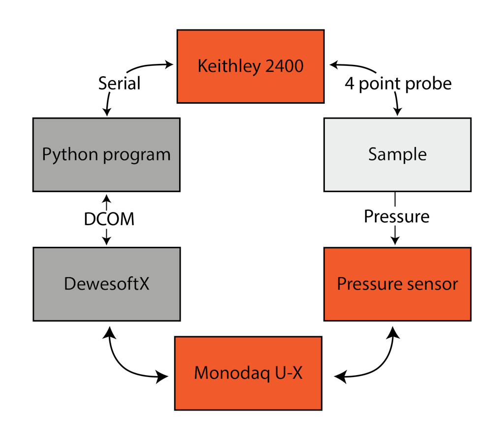

Figure 7. Block diagram of the project.

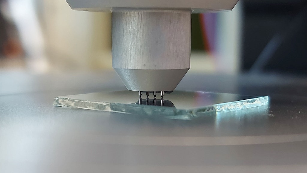

Figure 8. The probes are in contact with a sample.
Once everything is ready, the pressure measurements begin, and you can set up the sample. When the pressure is within the set interval, the program will ask for the parameters of the measure:
