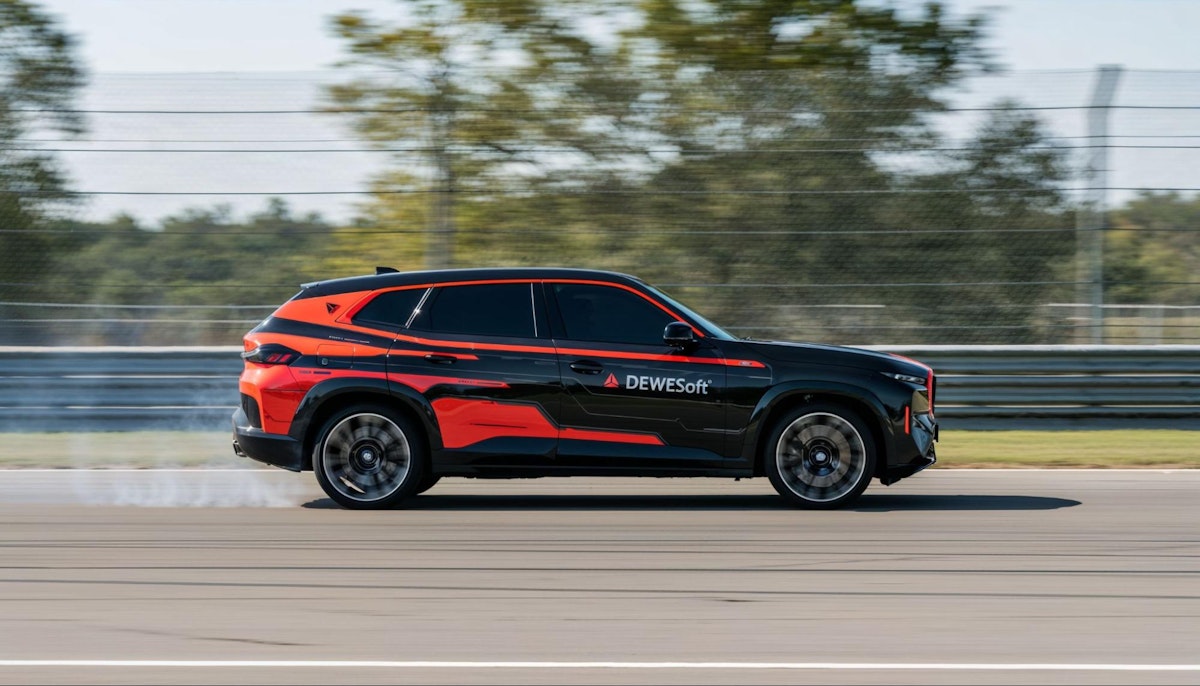

Figure 12. The Dewesoft BMW XM on a test track
