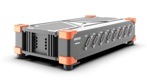

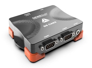

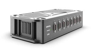

Tekniska specifikationer för USB CAN-bussgränssnitt
DS-CAN2SIRIUSim-4xCANSIRIUSi-8xCANSIRIUSif-8xCANSIRIUSiw-8xCANKRYPTONi-2xCAN USB
Interface
TypeUSB 2.0USB 2.0USB 2.0USB 2.0USB 2.0USB 2.0 EtherCAT passthrough Power only
CAN ports specification
Number of ports248 + 18 + 18 + 12
Interface typeCAN 2.0BCAN 2.0BCAN 2.0BCAN 2.0BCAN 2.0BCAN 2.0B
Connector type 9 pin D-SUB9 pin D-SUB9 pin D-SUB9 pin D-SUB9 pin D-SUB9 pin D-SUB
Interface data rateup to 1 Mbit/secup to 1 Mbit/secup to 1 Mbit/secup to 1 Mbit/secup to 1 Mbit/secup to 1 Mbit/sec
Special protocolsOBDII, J1939, CAN outOBDII, J1939, CAN outOBDII, J1939, CAN outOBDII, J1939, CAN outOBDII, J1939, CAN outOBDII, J1939, CAN out
Galvanic isolation (Sensor supply not isolated)IsolatedIsolatedIsolatedIsolatedIsolatedIsolated
Bus pin fault protection±36 V±36 V±36 V±36 V±36 V±36 V
Power specification
Power supply6 - 36 V DC Startup voltage 7 VMax voltage 5.00 V ±0.25 V 2x USB 2.0 powered9 - 36 V DC9 - 36 V DC9 - 36 V DC6 - 50 V DC from EtherCAT passthrough Startup voltage 7 V
Maximum sensor power consumption 3 W max total (max 2 W on 15 V)2.5 W max total1 W per channel1 W per channel1 W per channel5 W max total (max 3 W on 15 V)
Maximum power consumption 5.5 W5 W Combined device & sensor consumption6.5 W (instrument) + 8 W (sensor)6.5 W (instrument) + 8 W (sensor)6.5 W (instrument) + 8 W (sensor)5.5 W
Environmental specification
Physical dimensions 105 x 90 x 30 mm 3.94 x 3.54 x 1.18 inch145 x 139 x 64 mm 5.71 x 5.43 x 2.52 inch266 x 139 x 64 mm 10.47 x 5.43 x 2.52 inch266 x 139 x 64 mm 10.47 x 5.43 x 2.52 inch282 x 135 x 70 mm 11.10 x 5.47 x 2.76 inch213 x 54 x 56 mm (slice) 213 x 54 x 71 mm (with connectors)
WeightWeight 230 g 0.51 lbsWeight 800 g 1.76 lbs1320 g 2.90 lbs1320 g 2.90 lbs1930 g 4.25 lbs575 g 1.27 lbs
Operating temperature -20°C to +60°C-10°C to +50°C-10°C to +50°C-10 °C to +50 °C-40 °C to +60 °C-20 °C to +60 °C
Storage temperature -40°C to +70°C-40°C to +70°C -40°C to +70°C -40 °C to +70 °C -40 °C to +70 °C-40 °C to +70 °C
Humidity5 to 95 % RH non-condensing at 50 °C5 to 95 % RH non-condensing at 50 °C5 to 95 % RH non-condensing at 50 °C5 to 95 % RH non-condensing at 50 °C-5 to 95 % RH non-condensing at 50 °C
IP protectionIP50IP50IP20IP50IP65 / IP67IP50
