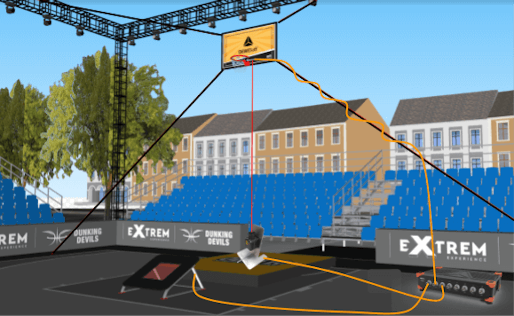

The measurement setup
Figure 3. The measurement setup on site.
Equipment used:
  1. Optical (laser) sensor: optoNCDT ILR2250 (Resolution 0.1 mm, Linearity < ±1 mm), sensor holder. Optical sensor was kindly provided by a Slovenian company TipTeh.
  2. Measuring device: SIRIUS-2xACC+-6xLV, connection to LV channel
  3. Adapter for connecting the sensor with the current output (DSI-20mA)
  4. A metal plate screwed into the basket
  5. Two 3-axial accelerometers with 20m cables
The optical sensor we placed below the basket
We attached a reflecting metal plate horizontally to the hoop
Figure 4. The optical sensor we placed below the basket. Figure 5. We attached a reflecting metal plate horizontally to the hoop.
We screwed the optical sensor into a holder to ensure stillness relative to the whole structure. We connected the sensor to the low voltage channel of the SIRIUS measuring device, using an adapter converting the sensor’s current signal into a voltage signal.
Additionally, we attached two accelerometers, one glued onto the leg of the trampoline from which the acrobats were jumping and the other to the backside of the backboard close to the hoop mounting.
Before every jump, the hoop was positioned and the height was measured with the optical sensor. We also measured the distance to the tile with this sensor and calculated the final distance relative to the offset based on the mounted optical sensor.

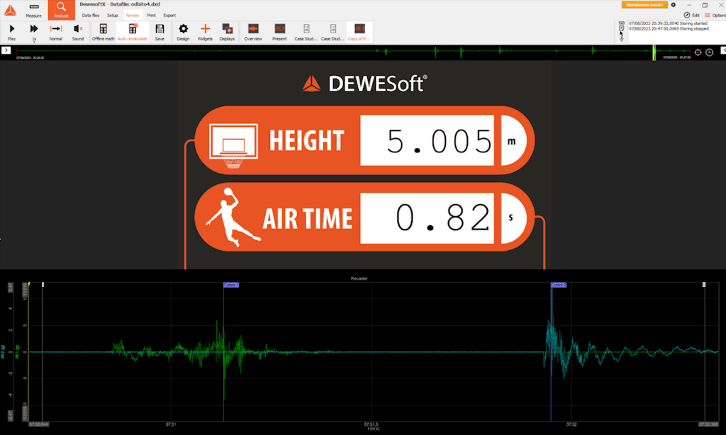

Airtime measurements
When the height was measured, we latched the value within the DewesoftX, and the acrobat could start with the dunk attempt - the acrobat ran to the trampoline, jumped on it, and then tried to dunk the ball into the hoop.
During this, we measured the vibration on the leg of the trampoline, and within this signal, we noted the value at the moment when the acrobat jumped off the trampoline.
After setting off the jump, the acrobat performed the dunk. Here we measured the vibration on the backboard and searched for the signal’s first peak indicating the time of collision between the hand and hoop.

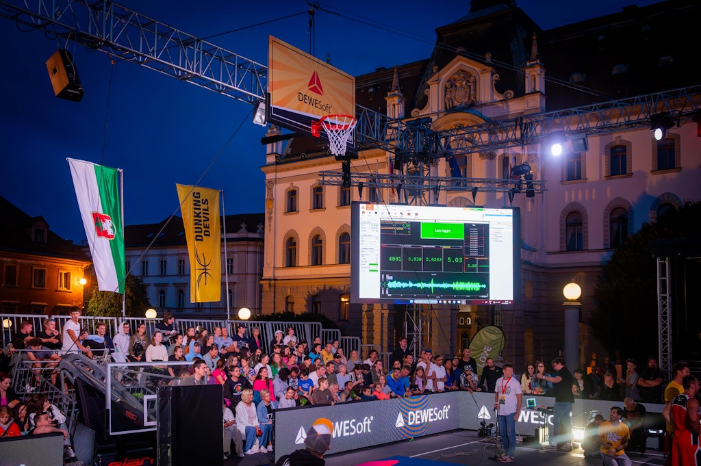

Only jumps including the dunk qualified. Each participant had four tries and all measurement results were displayed on a large screen at the arena. The two Slovenian Dunking Devils, Tadej Ambrožič and Luka Lorenčič, became record-setters dunking from heights of 5.005 meters.
Figure 6. The action is on! The event arena with the hoop rigged for measurement and a big screen displaying the results.

Figure 7. Measurement of a final successful dunk.
